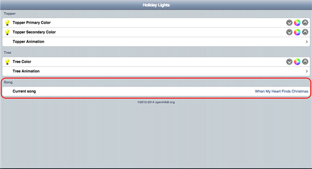

To do the same, but from openHAB, an entry is added to the items and the sitemap to call the script and bind to its output.
Item:
String xmasSong "Current song [%s]" (All) {exec="<[/home/pi/xmasradio.py:10000:REGEX((.*?))]"}
Sitemap:
        Frame label="Song" {
                Text item=xmasSong
The result in the openHAB GUI:
Checking the openHAB logs, the song titles are properly updated with every new song:
