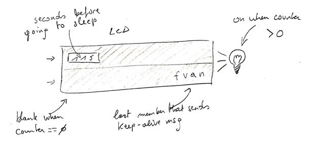

On January 6, we remove our Christmas tree and lights in Belgium. So it's also time for my Christmas Wreath of Things to switch off.
But we still have our Secret IoT Service going on - and I want to enjoy that for a little longer.

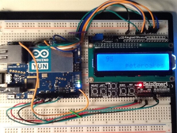

So I switched over to a low profile design: an LCD that glows when one of my Secret IoT Service partners is alive,
and shows the name of the last person that sent me an I'm alive message.
In the picture below, it was Robert Peter Oakes.
What's happening?
If no one but me is on-line, the display is blank, and the backlight off.
Once I receive a message from one of my friends, the Thing wakes up:
It sets a seconds counter to 120 seconds, and remembers the name of the sender.
The display lights up, and shows who was broadcasting:
Left upper corner shows my countdown timer. Each second the timer decreases.
Right lower corner shows the sender (in this case fvan).
If I receive no new message within 120 seconds, the backlight switches off, the display is blanked
and we go back to sleep.
