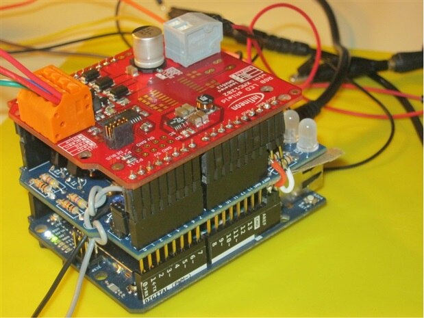

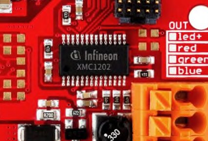

Infineon Lighting RGB LED Arduino Shield
This board is tagged as an RGB driver shield. But it is actually a fully capable microcontroller all by itself.
The manual for the evaluation board says 'XMC1200 Microcontroller Series for Industrial Applications'.
And that's no lie. The board hosts an Infineon XMC1202. One of its peripherals is 'Brightness Color Control Unit (BCCU) for LED lighting control'.
When using it as an Arduino shield, your sketch talks to the controller using i2c.
But since the shield sports a debug header, you could just as well program the on-board controller.
shabaz has written about that in his RGB LED Shield from Infineon - Getting Started Guide.
Using the board is not difficult, but I think Infineon can do  a better job explaining the configuration parameters and the limits calculations.
It is all understandable if you read their documentation for the shield and inspect the schematics a few times.
A nice narrative explanation of the concepts wouldn't be bad though.
However, I give Infineon an A for the completeness of specifications and principles of LED driving operation - and the elaborate explanation of that part.
Several road testers have made a library for the board. Compare the Infineon RGB libraries that spawned from the Internet of Holiday Lights

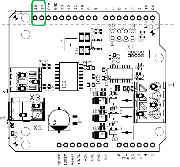

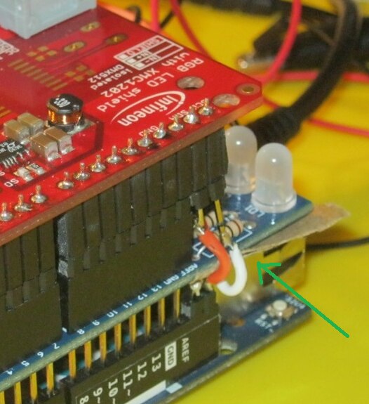

A watch-out: the shield uses D14 and D15 for i2c.
This can be an issue when this board is stacked on other shields that don't have these two 'newer' pins (e.g.: some of SparkFun and Velleman shields).
I had to do some bodge-wiring in my design:
And a second watch-out. This board (at least my board) emits a high frequency pitch when driving the leds. The pitch changes depending on the intensity.
This can be annoying if you're using it in a silent place - and your dog may complain.

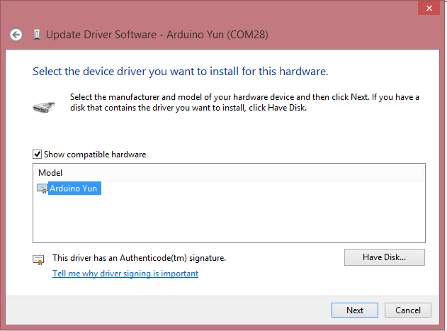

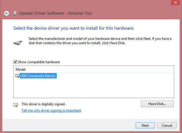

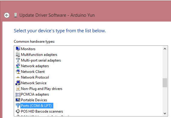

The USB connectivity is another story. It's been playing up from the beginning that I installed the Yún and is continuing to be a * in the *.
Disclaimer: I have a recent PC, recent OS and the drivers all installed ok.
But at regular times, the Yún disappears from the radar. And it doesn't get re-listed when I unplug it and plug it in again.
Even rebooting the PC does not help. And I have pushed all possible reset buttons on the Yún to no avail.
The symptoms are these:
- the Yún is not visible in the IDE.
- there's no COM port assigned to a Yún
- the Yún appears as a problematic device in the device manager.
Fixing it requires one or two steps. I haven't figured out why it is sometimes one and sometimes two steps.
If I select the Choose Driver from the device manager, sometimes the Arduino Yun driver is listed.
In that case I select that driver, push next, and the Yún is back in the USB world.
Sometimes the Arduino Yun driver is not listed. Then I have to first select the standard Port driver first.
After that I can go back into the 'flagged device', and the Arduino Yun driver is available.
Upon re-selecting that, the Yun is USB-able again.
So yes, strange. May be related to my PC - but still, it's a normal recent one, and it happens.

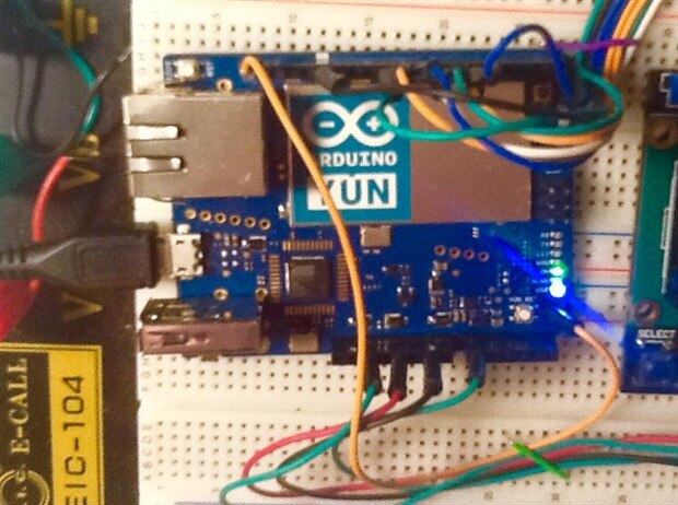

And what's that with the USB and Ethernet connector position on the Yún? They interfere with almost every shield in existence.
Either the pins of your shield are to short. Or when they are long enough, the two metal connectors shortcut something on the underside of your shield. Why?
None of my shields I have at home fitted (SainSmart, Adafruit, Velleman, Infineon).
