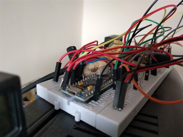

Every time Bernie is let out of the vivarium she goes for a wander up and around it, and (yes the power is disconnected) she enjoys crawling through the wires up against the ArduinoArduino that I currently have setup for the start of the monitoring and control project, we think that she would probably enjoy some more vines inside the vivarium as she also love to crawl into/up hair as well.image
So the plan, use an Arduino, or a couple of them, to control fans which would help to ventilate and also cool the vivarium when needed, it would decide when to do so by monitoring the temperature with DS18B20DS18B20s and react to temperatures outside of the desired parameters as appropriate.

Fritzing aside, the Arduino IDE steps up for programming the device and using the OneWire example as the basis, we have a very rudimentary program that can monitor the temperature input from the DS18B20 and output the PWM signal required to control the fans, here is a snapshot of the code from my github repo:
There's a lot of rough approximations here, and in fact this is only one version of the code and doesn't really take into account the potentiometer properly, yet. I had a hard time using the Arduino 'map' function to try to get it to control the fans in a rational manner (since they're 0-255 output for speed, and the potentiometer is 0-1023) it wasn't quite working properly (never reaching 100% speed and never going slow enough, input welcome).
