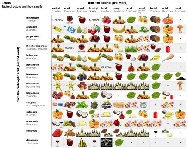

    dougw over 10 years ago in reply to dixonselvan
    Esters with low molecular weight often have fragrant odours and are commonly used as fragrances, perfumes, essential oils, food flavourings, cosmetics, etc.
    Usually, esters are derived from a carboxylic acid and an alcohol such as glycerol.
    The first ester I ever made in a chemistry lab smelled exactly like maraschino cherries.
    Here is small table of possible combinations I found on the net:
    Doug
    Doug

    dixonselvan over 10 years ago in reply to dougw
    Thank you so much Doug for your help image
