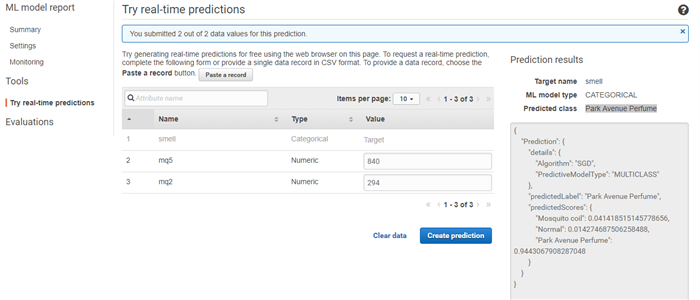

     For machine learning the smell, I have used the AWS machine learning service. This will create a machine learning model from the data source we provide, which has to be placed in the AWS S3 storage service. Once the model is created, we can try real-time predictions of smell in the AWS machine learning console. Also, we can create an endpoint using which we can request and receive predicted smell information in a JSON format. I have created a web service in my local which will make a request to the Machine learning endpoint with data inputs from the mq5 and the mq2 gas sensor connected to Arduino MKR1000. This will be used by the machine learning model to predict and provide a JSON response. From this response, the smell information will be extracted. All this happens, when we ask "Alexa, how does that smell like". The output will be passed to Alexa to voice out, which will be the name of the smell. Also, Alexa can check the environment when asked to do so (not automatically) and alert if there is a dangerous smell in the environment. For now, I have programmed the mosquito coil as the dangerous smell. When this is sensed, Alexa will voice out the alert message and then Arduino MKR1000 will turn ON a fan to probably extinguish the mosquito coil (smoke)! It can also turn OFF an electric stove if it is connected to the extension box which is in turn connected to the relay.

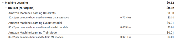

     The AWS machine learning costs as per the usage. The other services used in this project are free of cost. To provide an overview of how much it costs for usage, a screenshot of my bill for initial usage is given below.
     Since this is neither completely an open source service or was I able to find one within this timeline, I will provide the documentation which I followed to create the machine learning model. Here is the documentation from Amazon for setting up ML - Click here, for a tutorial - Click here and for an introduction to AWS ML video from YouTube - Click here (this is not from Amazon). For the dataset/ data source which I used to create an ML model - Click here.
     The machine learning model uses a multiclass type of prediction and below is a screenshot of a real-time prediction of smell in AWS machine learning console.
