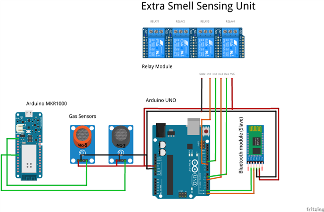

     It is late but at least now I realized that the Bluetooth communication between master and slave can be one-way communication and the other way will be an acknowledgment. As per the initial plan, the gas sensor data from the extra unit to the main unit should be through Bluetooth. But I have now revised it (considering the time to complete) and made it as a transfer through wire/ connection through a wire. The gas sensors will be powered up by the extra unit and the analog values from the sensors will be transferred to the analog pins in Arduino MKR1000. Then, the Arduino MKR1000 will feed all four values to the IoT Platform. However, the relay control will still be through Bluetooth and there is no change in it. So for the extra unit to be placed in a separate room, you can just extend the wire between the main and extra unit.
     If I have had an extra Arduino MKR1000, I would have replaced it with the Arduino UNO in the extra unit. That way the communication to the 'thinger.io' platform would have been two gas sensor values from the main unit and two from the extra unit. Now all four will be from the main unit.

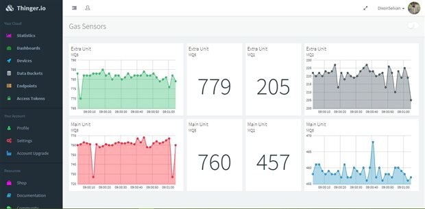

Data Transferred to Thinger.io
     The image below shows a graphical and textual representation of data from gas sensors connected to Arduino MKR1000, sent to thinger.io
     Below is the video which shows the real-time graphical and textual representation in thinger.io of data received from the gas sensors connected to Arduino MKR1000 and how they react to various gaseous smells. Later these data will be stored in an excel sheet in .csv format which will then be fed into a machine learning service.

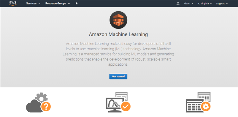

Machine Learning
     Much of the machine learning part will be discussed in the next and final blog. I am planning to use the AWS machine learning service by Amazon. The input for this will be the data from gases sensors connected to Arduino MKR1000 fed to thinger.io IoT platform which will be compiled into a .csv file and fed into the service for machine learning. YouTube Video Reference - Link. The outcome is the identification of smell.

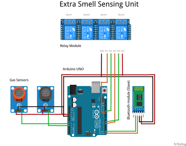

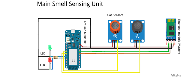

Circuit Connection
     Below is the circuit connection diagram of the 'Cue System for Anosmia' part of my project. This comprises of the gas sensor pair (MQ-2 and MQ-5) and the Bluetooth modules (master-slave) connected to the Arduino MKR1000 and Arduino UNO. Apart from this, there are two DC fans connected at the front which will act as an inhaler and cooling system, as the gas sensor tend to heat up (they are designed to heat up and obtain corresponding voltage variation for the gas in the environment). These fan's power adapters are connected to the extension board which is in turn connected to the four channel relay module. All these are packed up in a case. For more information about the case / complete hardware of my project - visit this link - Cue System for Anosmia and Smart WheelChair #7 - Hardware Explained and Case
Master Bluetooth - Arudino MKR1000
     The LEDs are for the purpose of alerting and status.
Slave Bluetooth - Arduino UNO - After Revision
     The Arduino MKR1000 belongs to the 'Main Smell Sensing Unit'. This has been placed here to show how it is connected through wire after the revision of the initial plan.
Slave Bluetooth - Arduino UNO - Before Revision
