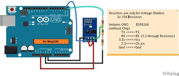

For four days trying to communicate esp 01, unsuccessfully, I already changed and firmeware. I use Arduino and I never have any problems with sensors to Arduino or ESP is complicated. the only thing I managed to get through communication Arduino IDE serial AT komands
I do not know if I have a problem with Hardwear or softweare
Interests proven example of programming of ESP 01 which firmevarom and how to set up the Arduino IDE.
Connected to the scheme, with a separate power supply 3.3V
Who can help me here thanks in advance.
Or I'll leave and throw it in the trash
Tnx Damir

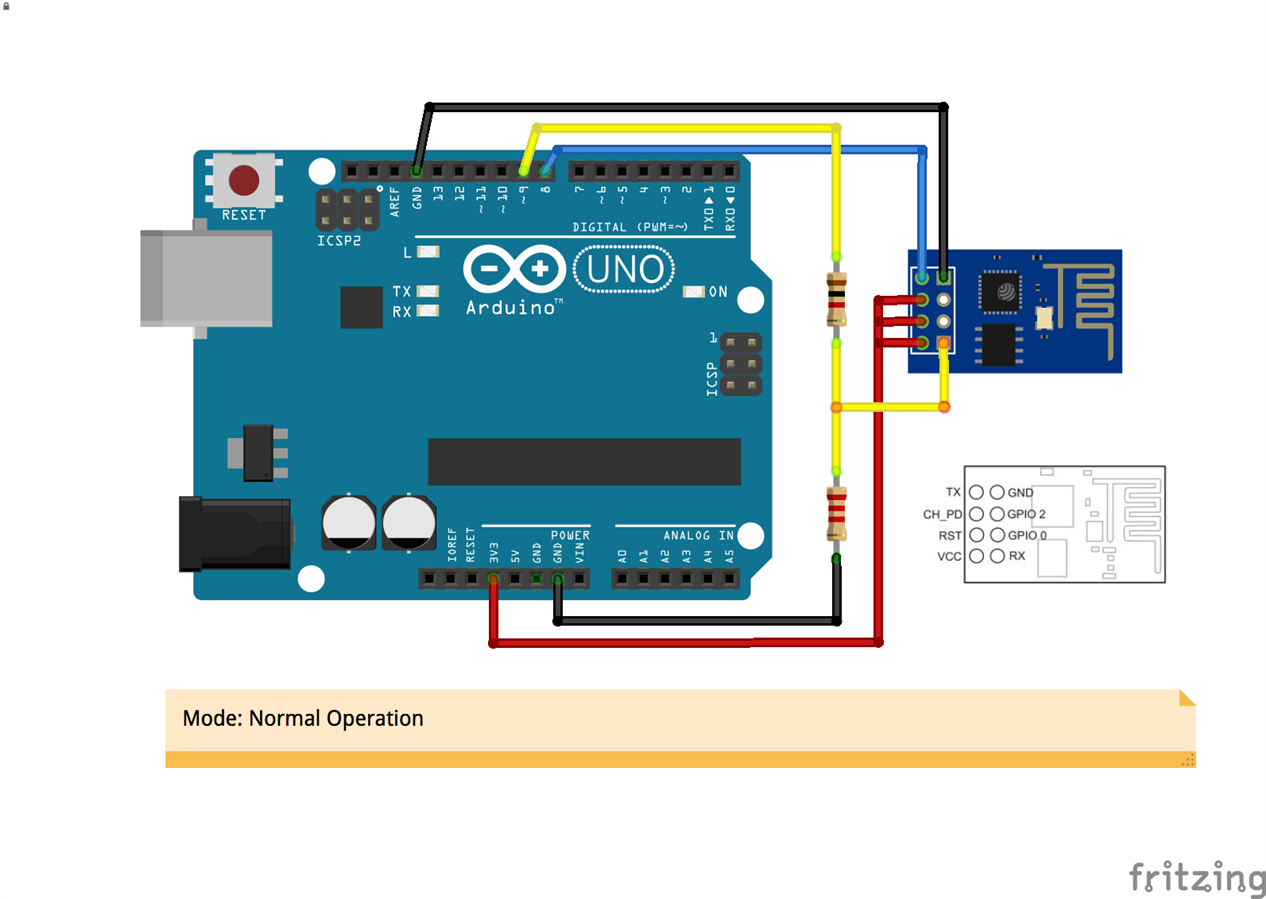

    I got it. Connected to the scheme on the serial port ardu going gets feedback from ESP AT commands. But when I want to program esp occurs fault serial is not in sync. chart below.

    Oh, this is all frustrating, I saw and followed the instructions on the page that you suggested but without successful results. I watched and this page
    http://esp8266.github.io/Arduino/versions/2.1.0-rc2/doc/installing.html.
    I'm so confused I do not know any more how to connect, do not know not what I know
    ESP       arduino
    tx             tx
    rx             rx
    or
    ESP        arduino
    tX             rX
    rx              tx
  • Former Member
    Former Member over 9 years ago in reply to Former Member
    With this scheme, the AT commands work, and Arduino  communicate with ESP but i can not program ESP, I don `t know why
    , although they follow all act to be gpio0 to GND and so on.
    ESP8266 01 is from china but think I do to corect wiring.

  • Former Member
    chart below.

    Damir,  Hello.
    Here are some observations from my experience.
    1) Do not use the Arduino onboard 3.3v.  Use an external 3.3V supply.  The ESP pulls too much for the Arduino to handle.  This causes erratic behavior.
    2) I have used ESP8266-01 where I have needed to connect TX<>TX, RX<> RX AND some that need TX<>RX, RX<>TX.  Try both.
    3) I have had most success using the schematic from your Feb 5, 2016 6:58 AM post while using external 3.3v source for ESP.
    I believe your main problem is the 3.3v source.
    I hope this helps
