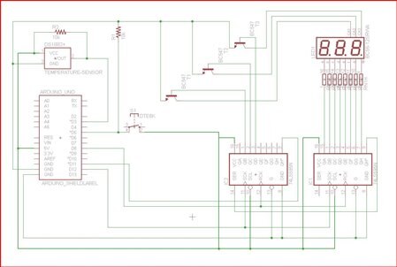

Ok the object is to display the temp in C & F on a 3 digit 7 segment display using the following.
Arduino Uno
Ds18b20 - digital One wire temp sensor
(2) 74HC_HCT595 - shift register
1k resistor network (shown under the LED)
3 digit 7 segment common cathode LED display
SPST NO MC switch
A few other odds & ends (see pic)
Total noob here so all input or better ways to do this is welcome!

    Unless you are using your other Arduino pins for something else, you definately don't need the shift register to drive the transistors. A 270R resistor from base to three output pins on the Arduin will work just fine.
    You don't need the other shift register either, unless your LEDs are high current, you can just use eight outputs from the Arduino through the series resistors, as long as you are not taking more than 40mA per segment.
    For example software for driving 4 digits in this way, download the sketches from http://www.arduinoevilgenius.com and look at project 30.

    The completed project will be a climate control for a car. Consisting of 10 buttons to control acuators and a servo. The  system will read inside and outside temp. and adjust acordingly. I was  thinking of using another shift register for the buttons. I'd like to  keep the pin usage as minimal as possible and code lean and tight.

    10 butons - 7 pins (buttons in 4 x 3 array - there is an Arduino library for key matrix)
    Actuator and servo - 2 pins
    LED segments - 8 pins
    LED common transistors - 3 pins
    Makes 20 pins image
    Only 18 available on the Arduino - you can use the Analog Ins as outputs too.
    So maybe keep the shift register for the segments.
    The more hardware, the more chance of something failing. Once the software is right, it stays right!

    Or go with a LCD in 4 bit mode to save some pins. Lower current as well and you can get nice backlit versions. Then of course you have actual text messages instead of numbers to make it more friendly. The LCD is really easy to use with the library. My son managed to talk to the LCD in only a few nights and he had never done any controller work in the past. Give it a try.
    Another possible thing is to multiplex the 8 lines for the LED segments with button scanning. You can scan the buttons so quickly the eyes will never detect you actually turned off the LED's and were using the bits to scan buttons! I've done this type of thing in the past but it adds complexity as you need to add a 8 input/16 output/1 control line mux to the wiring. Use two of these: http://www.rohm.com/products/databook/general/pdf/bu4551b-e.pdf

    The car this is going in is a Lamborghini Countach 25th Anniversary which had an LED display that I'm attempting to replicate. The second version will use a LCD display and be used in a Diablo Replica. I'm looking into possibly using the analog pins as digital pins using this ...
