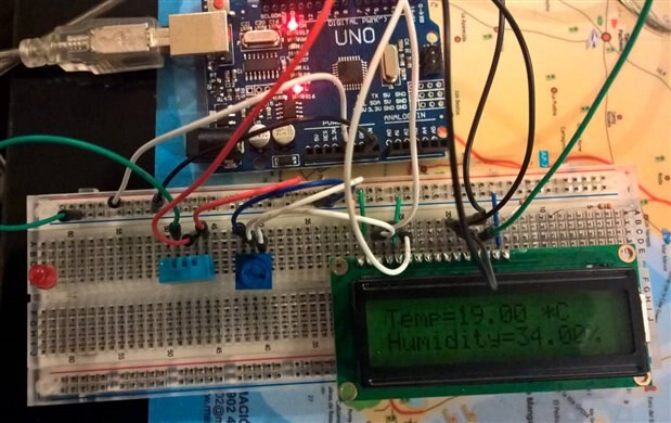

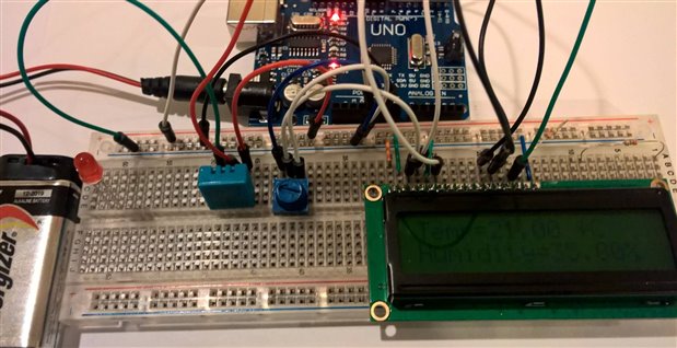

I have done the project in Jeremy Blum "Explorign Arduino" related to the three color LED changing with the temperature. It works right when connected with USB, but it is always red if connected to 9V.
Did I do anything wrong? is it normal? how can I solve it?
The sensor is a TMP-36image

    Hi Jose,
    Your hookup looks good. As Brian has pointed out there is no reason why it will not work if the power source is solid and hooked to the DC input jack or to the Ground and Vin terminals of the Arduino header. I would also put a 0.1 uF cap across the 9 Volts near the Arduino. That book by Jeremy is excellent and I had a lot of fun working through it a while back.

    Thank you for the answer. I have checked with another board with a LCD and a DTH 11 sensor and the difference is 2 degrees centigrade between USB and 9v. What I can't understand is why. I thought the board provided 5v when connected to either 9V or USB.  I have checked the battery and it is providing 6.54v.

    mcb1 over 9 years ago in reply to clem57
    I think you'll find that the 5v line is less than 5v while being powered from USB.
    Clem is correct that it will need recalibrating.
    I tend to always use a Dallas One Wire DS18B20 (or similar) to avoid this.

    Do you have a reasonably accurate DMM - if so try measuring some voltages around you circuit and you will be able to work out what is changing and affecting the result - it might then be simple to deal with the problem. If you post the circuit you have I can suggest places to measure.
