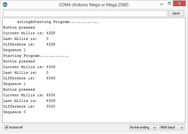

The basic premise works. The sketch starts out with one pattern and on the button push switches to the other pattern. However, the issue that I am running into is that after a short period one of the patterns gets "stuck" for some reason. You can view the issue in the video and the sketch is below as well as the serial output.
Another issue I am having is the initial serial output. For some reason the output is garbled and I have no idea why.
So is something wrong with the sketch or is there something possibly wrong with my Arduino? Thanks in advance for your time and advice.

Serial Output:

    I think you need to look at this: https://www.arduino.cc/en/Reference/AttachInterrupt, which includes the following:
    "inside the attached function, delay() won't work and the value returned by millis() will not increment............... See the section on ISRs below for more information"
    I also followed the link labelled "Nick Gammon's Notes". Nick gives some simple rules about writing ISRs, including: "Don't Use Serial Prints"
    My own experience of using ISRs is to Set a flag inside the ISR and use the flag externally to indicate the need to execute a new section of code.

    Yeah, I was aware of the delay thing and that millis wouldn't increment. However, I thought that the process was moving through so fast that it wouldn't matter in an interrupt like that. Plus some of the examples that I ran across online for interrupts used pretty much the same process.
    So you think it might be with the Serial.println in the interrupt function?

    Here's the serial output I forgot to include in the original post.

    hi dukeofmarshallHow about making your ISR as short as possible - eg do nothing apart from setting a flag to show that an interrupt has been received. Then in your main code - which is continually looping  - check the status of the flag and use that to decide whether or not to execute the code that currently sits in your ISR, remembering to clear the flag before you return to the main code.
