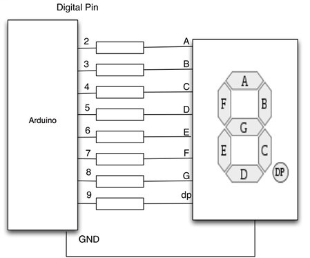

    thanks for the reply. I also wanted to know how to interface with a seven segment display?
    thank you
  • simon.monk
    simon.monk over 14 years ago in reply to e14 Contributor
    @Shelton - A 7-segment LED display can be thought of as 7 (or 8 with the dot) separate LEDs. A common cathode 7-segment LED module will have all the negative ends of the LEDs connected, a common andode all the positive.
    See the figure below from the book  '30 Arduino Projects for the Evil Genius' below, that shos how to connect one to an Arduino.
    The book has a number of 7-segment LED projects.
