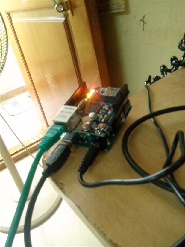

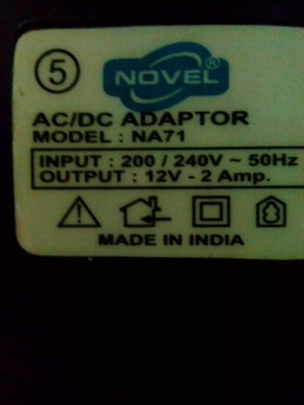

    I also replaced the EthernetShield as I checked with the vendor.They confirmed that the IC has gone due to short circuit.
    I previously connected only USB cable with Arduino+Ethernet Shield.I didn't connect external powersupply.Vendor adviced me to use both..
    I will do both the USB and external powersupply connections with the new Ethernetshield and proceed with what you have adviced now.
    I will update you the progress.
  • clem57
    clem57 over 11 years ago in reply to e14 Contributor
    Never thought to ask about power. That could help! Thanks for the update.
    Clem
    e14 Contributor over 11 years ago in reply to organtin
    I am using new Ethernet Shield which the vendor told working component.I connected both the power supply and USB.
    Pics of Power supply adapter and Connections for your reference below..

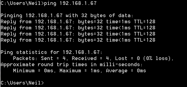

    generk4 and organtin Hi Radhamani and Giovanni - I had 30 minutes to spare so I copied the program from comment 19 and posted it into the Arduino IDE (I am using 1.6.1), compiled and uploaded it to a genuine Arduino UNO R2, fitted with a compatible Ethernet shield.(HanRun HR911105A 12/11) which carries a Wiznet chip.
    The Ethernet shield was connected to my Router with a standard Ethernet Cable.
    I was able to get the following:
    So I think the problem must be with your setup, Radhamani.
    1. I didn't find it necessary to connect both the USB AND an external PSU to the Arduino. Not sure why you have been advised to do that.

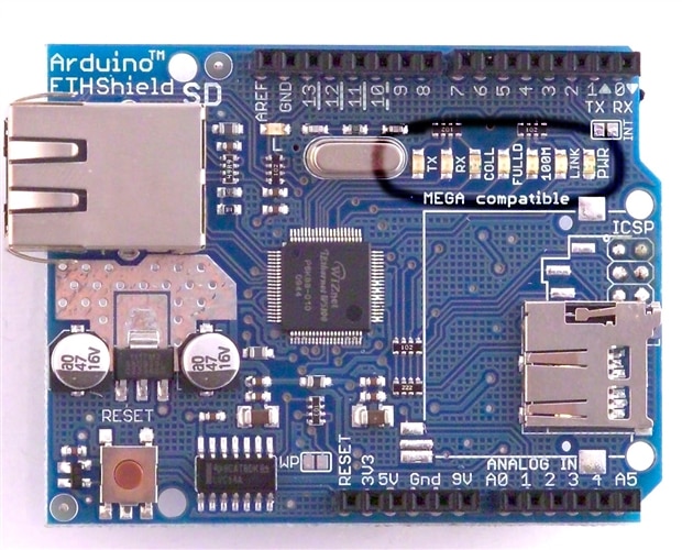

    2. There is a bank of LEDs on the Ethernet shield....do they light up, proving that your shield is actually connected to your network?image
    Try pressing the RESET button if they don't light up; make sure the ICSP connector is properly pushed home; try a different Ethernet cable.
    Hope you get it working
    Neil
    Postscript - I was also able to telnet to it and get the elapsed time and reading
    Neil

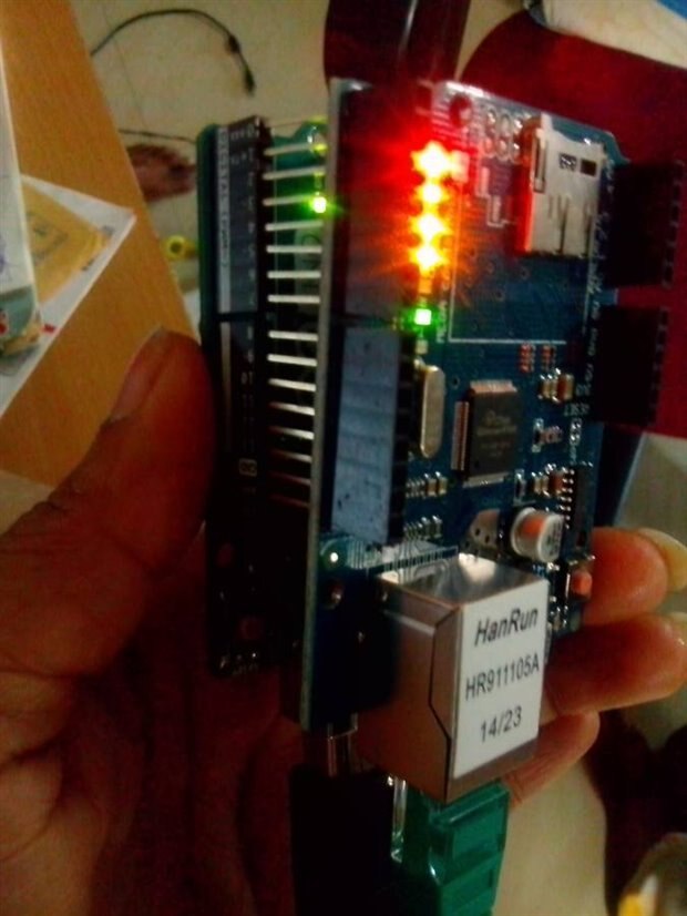

    e14 Contributor over 11 years ago in reply to neilk
    Hi Neil,
    Thanks for your update...
    Actually,the vendor technical person told that he didnt replace with new Ethernet Shield.Hence,i might be testing with old Ethernet shield only.
    The technical person who gave me the product told i have to connect External powersupply otherwise chip will shor-circuit and go off.He is asking me to pay another 1000 bugs to get new one... image Feeling like they are cheating ...
    In the Ethernet Shield,all the 4 lights are blinking.And,RJ45 cable is working fine.I tested by connecting the cable directly from Router to my PC in LAN and Internet is connected without  issues..
    As all the lights are glowing,not sure why Ethernet shield is still having problem in IP setup.
