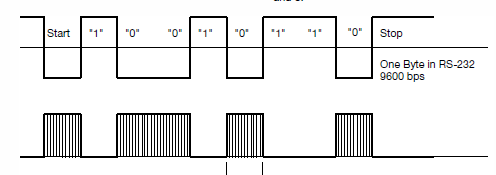

Hi all,
      I am a beginner to arduino trying to transfer data through LASER in arduino.but I couldn't read the transfered String and i am getting garbage values.I am using photodiode on the receiver side to detect the transmitted signal.I have connected the LASER and photodiode to Tx and Rx of two arduinos respectively.Should I use any modulation algorithms to transfer the data through LASER?? or Can it be transfered simply through Tx without any modulation??? Plz help me out

    Most modern optical transceivers I have come across use some form of modulation as this helps to eliminate the effects of normal visible and invisible light from interfering with the signal This is exactly…

    Do you mean infra red and not laser? Need the actual part numbers to know what specs they are. Clem PS Like this Connecting a Photoresistor to an Arduino

    What Serial baud rate are you using? Try lowering it to 300 or 600 and then see if you can get a result.

    The specs of the components are below:
    - Visible light laser 650nm 5mW of power.
    - Trigger for the laser based on a MOSFET IRF9630
    - Receiver based in three photodiodes of visible light SFH203.
    - Power via USB or battery of 4.5-5V.
    This is exactly what all modern TV remote controls do, they modulate the signal with a 38Khz carrier and the receiver filters out everything except this frequency before decoding the signal
    like this where you have a carrier for the "0" and no carrier for the ones, there are many ways to modulate, this is just one of them
    Hope this helps
