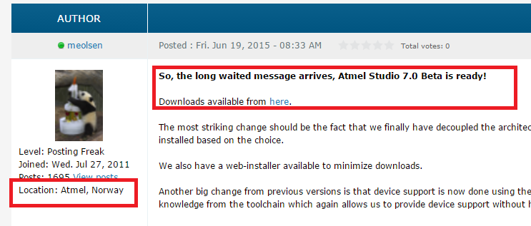

    Jan Cumps over 10 years ago in reply to Robert Peter Oakes
    I've read somewhere (but can't recall where) that the new version 7 of the Atmel Studio will also support SAMA5D4.
    There is a Beta program running at the moment...
    http://atmel-studio.s3-website-us-west-2.amazonaws.com/
    Jan Cumps over 10 years ago in reply to Jan Cumps
    Just started the install:
    The install has finished, and I can't find the SAMA5D4 listed. I'll re-search  the information and see if it was maybe announced for 7.1...
