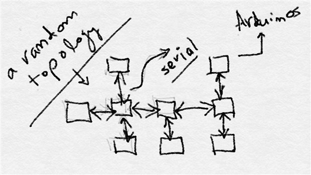

Hello all,
I am trying to talk to multiple (say 4) microcontrollers (Arduinos) at the same time. I was wondering if i can setup a serial connection, with a selection line that can detect the neighbor Arduino and enable the corresponding pin to start the serial communication between the two. something like this:image

    0 balearicdynamics over 10 years ago in reply to Robert Peter Oakes
    Peter,
    your suggestion has sense but. image
    If the nodes should be absolutely distributed on more than few arduino units as we are thinking, I suppose that in this biomedical application there is somethng like the need of a contemporary needs for reading. So the fact that some sensors will work without Arduino it is true but in the meantime I can't see how the sensor data can be processed - near simultaneously - if there is not a microcontroller. If a single Arduino board should dialogate with other six in the meantime the delays can be considered meaningless with the I2C bus interconnecting the units. But still a delay exist.
    In a grid like the one decised by karimkarim if every board has a small fixed number of board to dialogate with, it is replicated at least for every central node board. So the small delay of a single board, expands in a topography of this king creating a meaningful delay when there are more "six groups nodes" connected together. There are two possible changes that I will adopt in if I were Karim:
    The first is to change the topology to reduce the hierarchy of the boards, adding more cross connections to the board. If every Arduino is connected with all the proximity boards there are more links per board but with a resulting global faster distribution of the data flow as the number of effective delays are reduced; take a look to the modified topology scheme in the following image:
    Adding few more links (the dashed lines) to the original topology designed by Karim (the straight lines) the paths are drastically reduced and the average delay to send a generic data package between two board is reduced too. For example, a data packet sent from the board A2 to the board D1 in the original topology should follow the pathimage
    [A2] -> [A] -> [B] -> [C] -> [D] -> [D1]
    While including the dashed connections to the grid it can be reduced to
    [A2] -> [A1] -> [D1]
    This kind of topology has also the advantage to offer in most cases different paths for the same extreme points with the following advantages:
    1. If the immediately next board when needed has the bus busy (is working with another board) the path can be dynamically changed starting from that node.
    2. There is a more balanced distribution of the data charge between nodes.
    For example supposing that in the second example, when the data packet arrives from [A2] (starting point) to [A1] (better next node). The next better node to reach [D2] is [D1]. If it is busy, instead of waiting for the bus freed the destination point [D2] can also be reached with the alternative (longer) path [B] -> [C] -> [D] -> [D2]
    This kind of nodes communication is similar to the node distribution strategies of the network and the algorithm to find the next better node from every node is not difficult to calculate (we should think that these are microcontrollers).

    As I mentioned, I need to have mesh network with any unit being able to talk to (at max) 4 to 6 other units. So a chain topology is out of perspective. There was an image I shared, which I am attaching to this post for your attention. Having said all this, and I am assuming you have kindly had a look at the discussion, could you be more specific about the XMOS devices? Also, could you, at all, comment on the soft serial? By a low-end PIC do you mean an Arduino? I appreciate you being more precise.
    Karim.image

    well may be I am misunderstanding your point. but what you are suggesting is a main bus line with units connected to it. However if i may give a more complete diagram of the problem, here it is:
    now please consider the fact that this system is a mesh, not a bus,not just a star.
