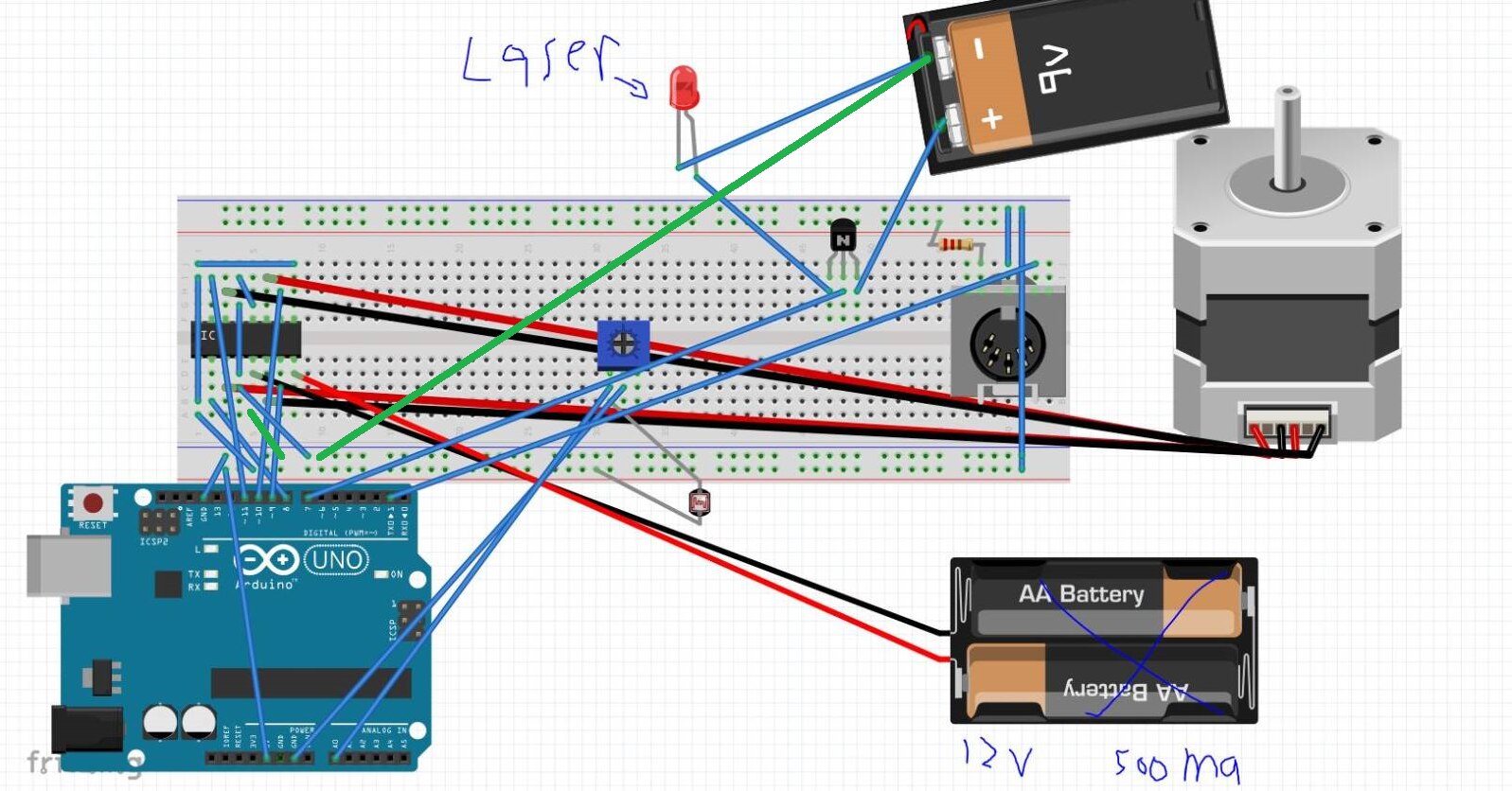

This instructable really interested me, Frameless Laser Harp - 4 , but i've never worked with steppers before.  the stepper i got has 4 wires, but the stepper in the instructable has 6.  on page 2 there is a wiring guide, but that wasn't very helpful to me, i didn't really understand what i'm supposed to do with the wires.  This is the stepper i have, https://www.sparkfun.com/products/10551?gclid=Cj0KEQiApruyBRCFqoDu1pbk9rkBEiQAF8EFdVmEBorGt6koPmFkaibEpRmZ94Z6r8BWhmTqAL… .  Any ideas?

    reverse... to change direction lol now more seriously... then you wire up the stepper motor, if it is not going in the direction you expect for the command your giving then you can change the code or simply…

    All Grounds (0V) should go together, the ground of the 12V, the 5V etc all are connected together at a common point the 5V goes to all those pins because it is 5V logic input to the chip and those pins…

    your stepper is a classic 4 wire / 2 coil 7.5deg per step so 360/7.5 = 48 full steps per revolution
    also it looks like the black and orange are one coil and the brown/yellow the other
    if you want to reverse the direction in hardware then simply swap the connection of black and orange (Put the black where the orange was and the orange where the black was) or do the similar thing with the other coil wires
    Hope this helps, if you need more info then just ask

    What do you mean reverse? ND when u day put the orange where the black is, do u mean up the orange wire into where the black wire is supposed to go on the Ic? Also, I still don't know how to wire the two common wires, 1 per coil.

    OK that was very helpful, now there is only 1 thing i'm still a bit unsure about.  for the ground connections.  do i connect the arduino ground to the stepperpsu ground and connect those(as one wire) to any of the ground pins? or do i connect the stepperpsu ground to one ground terminal on the chip, and the arduino ground to a different ground pin on the chip? or does it not matter @peteroakes

    As long as you have reasonably thick wires from the chip to the powersupply then you can use the powersupply 0V as you common point

    Robert Peter Oakes I'm not 100% sure what that means.  Do I have to hookup the arduino gnd to the chips gnd? Or just the psu?

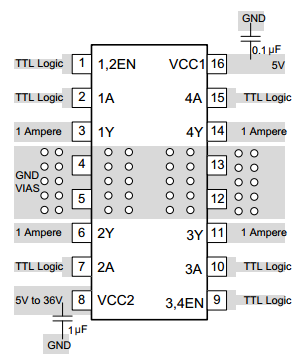

  • jc2048
    0 jc2048 over 10 years ago in reply to gub11
    "... or do i connect the stepperpsu ground to one ground terminal on the chip, and the arduino ground to a different ground pin on the chip?"
    Connect all the GND pins of the stepper chip together at the chip. That's what TI intended for you to do. (On a PCB the pins would come down to an area of copper that would tie them solidly together and also provide for some heatsinking. In your case (400mA), it looks as though what you're doing falls within the capability of the device to dissipate power from the package alone, though you might want to add some heatsinking anyway in case you want to use it at a higher current or simply to improve the long-term reliability)

    jc2048 where do I get heatsinking?
  • Robert Peter Oakes
    0 Robert Peter Oakes over 10 years ago in reply to gub11
    an old motherboard and pull one from the small chips on the board is one possibility if you have access, if not there are plenty available from element14 (Newark / Farnell) or even ebay, search for stepper controller heatsinks and it should bring something up but as Gabriel stated, for the low current your switching, you probably wont need one, when you are running it, feel the top of the chip with the back of your hand or carefully with a finger, if you cant keep you skin in contact for more than  a few seconds then you need a heatsink, otherwise your probably good to go

    In case it helps, this is how the temperature calculation works for the chip. If you are working with different currents to what I've assumed here (400mA in each coil) you can rework it accordingly.
    The bridge has an upper transistor and a lower transistor on each end of the coil. For this application, if an upper transistor is on you also have the opposite lower transistor on. If the lower transistor is on, the opposite upper is on. That's how you get the current to flow in one direction or the other through the coil.
    Note from that there is always one upper and one lower on at any time.
    Looking at page 6 of the datasheet [section 7.6 Typical Characteristics] you can see that for 400mA the upper transistor drops about 1.1V.
    So that's a dissipation of 1.1V x 0.4A = 0.44W. That ends up as heat in the chip.
    The bottom transistor drops about 0.9V, so that one is a dissipation of 0.9V x 0.4A = 0.36W
    Total for the two is 0.8W. Since there are two coils that gives a grand total of 1.6W.
    Although the output transistors are most of the dissipation, the rest of the circuitry does take some current too. The datasheet gives a max of 70mA on the +5V supply, but that's for all outputs low; let's average the figures for all low and all high and go for 50mA which adds 5V x 0.05A = .25W to our dissipation.
    So the total for the chip is 1.85W.
    That's a lot for a DIL package. You wouldn't expect an IC to disspate more than 0.5-1W without extra help (very variable, depending on how the chip is mounted inside, so always refer to the datasheet and don't guess).
    The datasheet says the thermal resistance of the part is 60C/W. So, if we have 1.85W of heat flowing from the chip to the outside, we'll have a temperature rise of 111C. That's a temperature rise above whatever the ambient temperature around the package is. For an ambient of 25C, that means the chip inside will reach a temperature of 136C. The datasheet recommends a junction temperature of no more than 125C, so it looks like you should use some heatsinking.
    The problem for you, even if you're happy to run it above the recommended figure, is that if you have it in a confined space (without forced cooling) the ambient temperature will rise and may take you to the point where it shuts down. (You won't damage the part because it has a temperature sensor and shuts itself down when the chip gets to 150C or so, but it's always a bit mysterious when you have a chip that doesn't work for a while and then suddenly springs into life again when it's cooled down a bit.)

    That's really helpful, I looked for heatsinking on ebay and element14's store, but couldn't find anything, coudl you link me some cheap heatsinking (i live in the US).

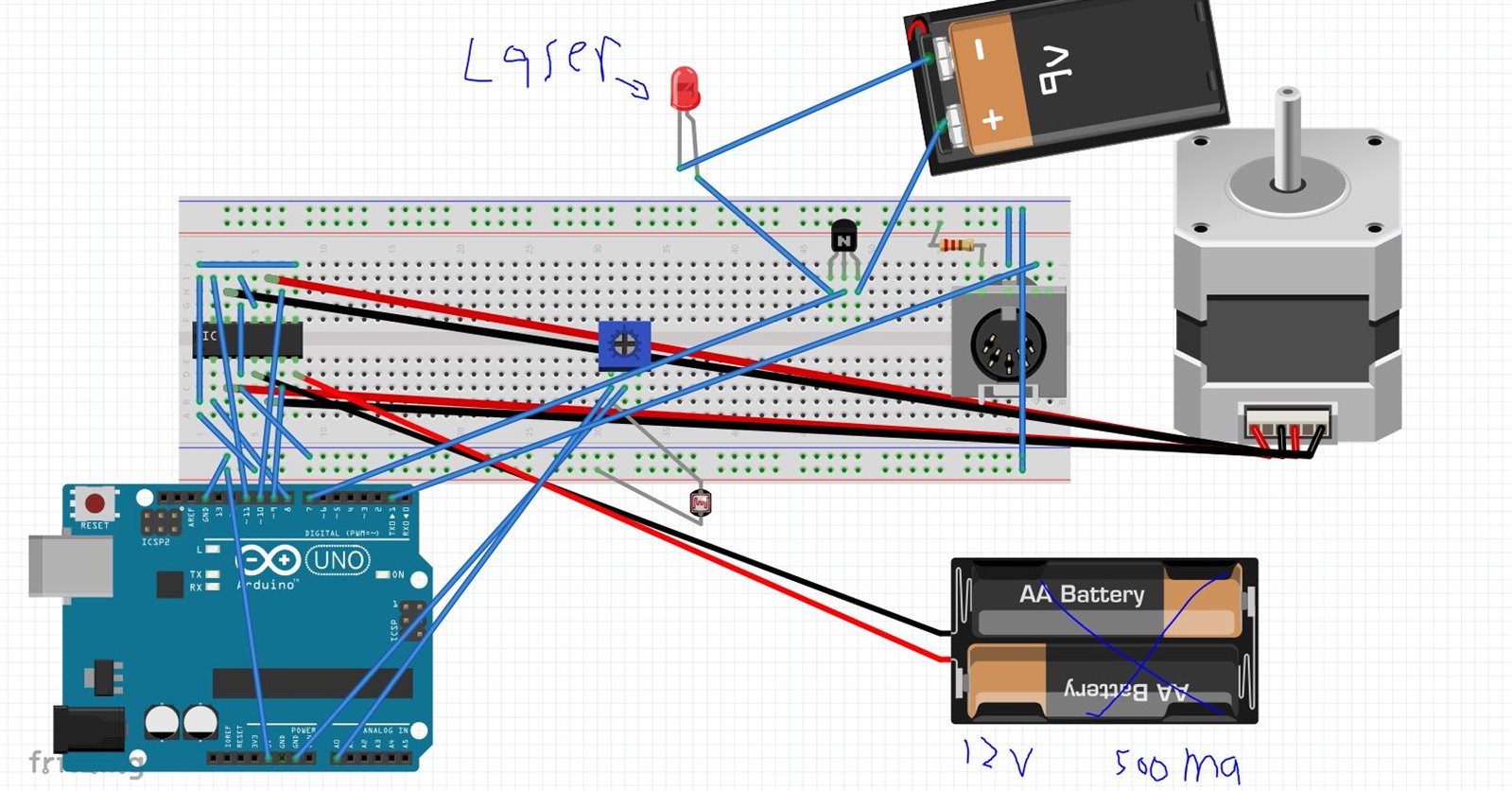

    I finally got the stepper driver and I put it all together, but I am having a few issues that I don't really know how to diagnose.  I did some trial and error, but that could only help so much.  First of all, the laser doesn't turn on, second the stepper has an odd pattern of off and on, when i think it's supposed to stay on at a constant speed.  I'll take a video of that and show a diagram of how I have it wired up when I get home.
    looking forward to the video so I can help diagnose the issue
    Can you also post the code you are using and the wiring sketch you ended up with when you post the video
    Sorry, I'm not in the US.
    This is a glue-on type:
    http://www.newark.com/fischer-elektronik/ick-14-16-l/heat-sink/dp/35M3896
    This is a clip-on type:
    http://www.newark.com/aavid-thermalloy/580200b00000g/heat-sink/dp/18M8201
    The clip-on type is more expensive, but you can reuse it.
    Whether it makes sense for you to buy from Newark I don't know.
    TI really intended you to use the pcb, either by passing the heat down to a ground plane on a multi-layer board, or by having an area of copper next to the chip on either side on a two-layer board. The package resin doesn't conduct heat very well and they've engineered the chip to get as much of the heat down the ground pins as possible so although you'd certainly be helping with a heatsink on the top it's not as good value as taking the heat from those pins if you can.

    0 gub11 over 10 years ago in reply to Robert Peter Oakes
    Robert Peter Oakes
    Diagram is below and here is the link to the youtube video.  https://youtu.be/T0Lmc4enkbg
    diagram:  Imgur: The most awesome images on the Internet

    Based on this diagram it looks like none of your grounds are connected together (the 0V lines of both supplies and the arduino and the chip should all be connected together, see the green lines
    based on what I am seeing this should fix the electrical by having all devices and chips connected together via the ground (0V) line
    the reason the Lazer is not turning on is that there is no ground path for the transistor to return the base current to the arduino, thats why the first green line to be added from the 9V battery
    the possible reason the stepper is not working properly is that while the 12V supply has a return path to the battery, and the arduino is connected to a pin of the chip, the two grounds are not connected and therefor maybe excessive current through the chip or something similar therefor the second green added
    Robert Peter Oakes
    I am trying it right now, but I don't understand what that would change
    Robert Peter Oakes
    After doing exactley what you did in the diagram, the laser works now(YAY), but now i just need the stepper to stop being weird.  Now when i turn it on the stepper moves, stops for like half a second, then moves again
    Glad were getting there, I dont have the chip you have but tomorow I will look at the sketch for you, its 2:30AM here so im off to bed image
    Can you take a really good picture of your breadboard and post it, as high a resolution as you can so I can see all your connections
    I know you posted the fritzing diagram but I need to see what you did vs what you should have done image
    Thanks
