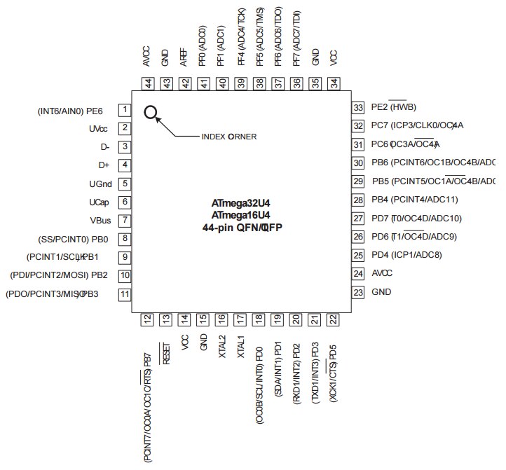

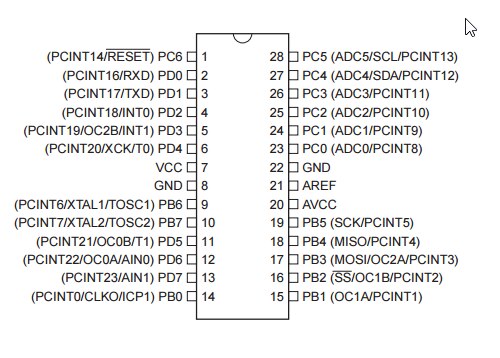

    These 2 boards use a different chip, as such they have different pinouts. the UNO has a 28 pin Plastic Dual Inline Package (PDIP) which is an ATMEGA328 and the Micro has a 44 pin chip (Quad Flatpack no leads (QFN) which is the ATmega32U4
    the two chips also have different internal functionality, the ATmega32U4 having quite a bit more than the 328
    the Wiring based  IDE hides most of these details from you but does allow access to the common functionality through the commands like digitalWrite, digitalRead, AnalogRead etc.
