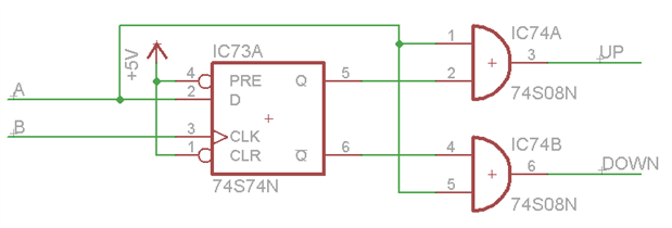

  • tomstr21
    0 tomstr21 over 10 years ago in reply to D_Hersey
    Oh .. didn't thought about that .. how do you think I should wire it ..any suggestions? image
