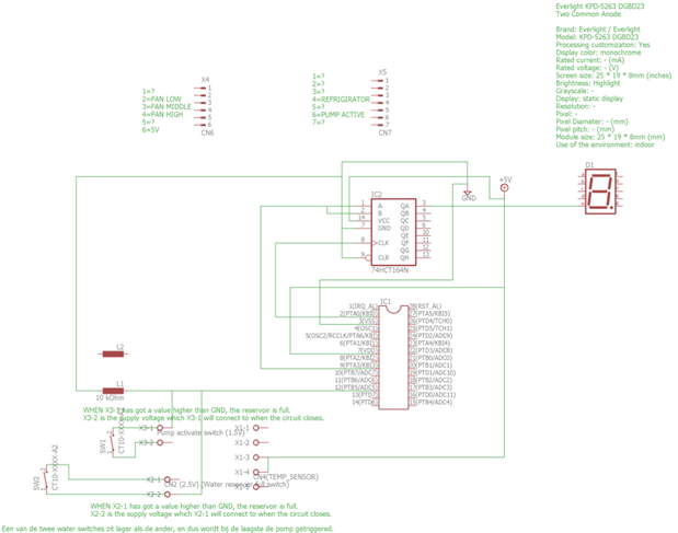

My selfmade and NOT complete schematic of the AC circuit
The values I get are usable, but they require taking loads of samples, and taking the average of all the samples, to check which line has got the lowest value (and thus is connected to GND). However, the values are fluctuating very much, and are not very accurate.

    If you're going to do all that, I think it would be worth your while sitting down with large sheet of paper and drawing out the circuit. It should be easy to do - you can see all the tracks, and the conventional…

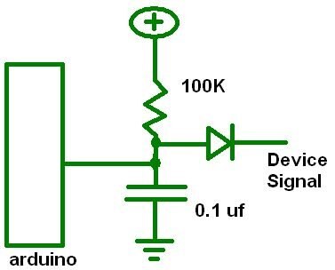

    It appears to me that your arduino input is completely floating - it needs a DC reference.
    I would try simply using a weak pull-up resistor on the arduino pin which should also have a capacitor to ground. The RC time constant needs to be longer than any of the multiplexing periods on the target signal. A diode can connect to the target signal, so it can pull the arduino pin down, but not up.

    If you're going to do all that, I think it would be worth your while sitting down with large sheet of paper and drawing out the circuit. It should be easy to do - you can see all the tracks, and the conventional components are simple to recognise. It will make it much more straightforward to plan your modifications. You'll also get more answers here because many of us can read schematics quickly but don't have the time (or inclination) to trace out a circuit from photographs.
    • Reject Answer

    How Large should the cap be? The Same as the one of the ones Im using now?
    jc2048 The first things I did was creating my own schematic of the board in eagle (I'm an absolute brginner in eagle, so tips are welcome. I'll post an image of the schematic later today)
    0 dougw over 9 years ago in reply to tim687
    I would try a 100K pull-up resistor and a 0.1 uf cap. Pretty much any diode should work, although a Schottky diode might be needed if the external signal doesn't go low enough.
  • tim687
    0 tim687 over 9 years ago in reply to dougw
    dougw  Since I am completely new to caps, how to I connect it? Pull up at the + side followed by a diode that connects to the Arduino? Thedanks for your help! I really hope that this should work
