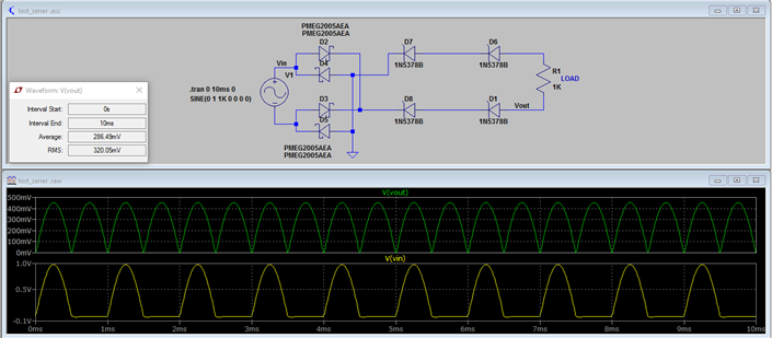

  • anishkgt
    0 anishkgt over 8 years ago
    So i've been simulating this, sharing graphs
    At 240vac
    At 1vac

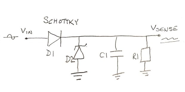

  • fmilburn
    0 fmilburn over 8 years ago in reply to anishkgt
    In simplest form, I believe Douglas Wong was suggesting something like this:
    D1 is a Schottky which is used in order to minimize the voltage drop to around 0.3V and serves as a half wave rectifier.  D2 is a Zener which should be specified at a voltage which will protect the Arduino (i.e. clamp).  R1 is high resistance, say 100k, so as to minimize current.  The value of C1 is chosen to smooth out the voltage where it is sensed.  It goes without saying that all components should be able to handle the maximum voltage at Vin, but there, I said it anyway.
    dougw, if I got this wrong I would be appreciative of your comments for my own education.
