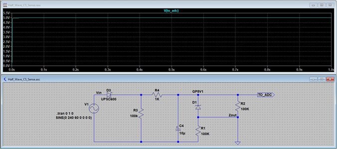

Hi All,
I am trying to switch on a LOAD from its OFF state by detecting a change in the voltage. Here the load is a MOT, the voltage at the primary is 1VAC when OFF.
My idea is to switch ON the MOT by detecting the voltage change at the primary when the Secondary are shorted. I can see a voltage drop of .5VAC when shorted. How can i monitor this voltage change with an Arduino.
My solution to the problem is shown below.
The Live of mains is connected to the MOT through the LIVE_LOAD in the schematic. During the OFF state the Optocoupler is triggered so that the 1VAC is seen by the Precision rectifier LT1078 and is rectified and send to the Analog pin A0 on the Arduino. With a code i could detect the voltage change and use it trigger the MOT again and at the same disable the optocoupler to break the circuit to the LT1078. Basically eliminating the need to press a switch two switch ON the MOT.
is there a better way to get this done. I was thinking of using the basic 1N4007 to convert the 1VAC to dc but that would be a problem when the MOT is switched ON allowing the mains 240VAC to flow through the DIODE.
    dougw over 8 years ago in reply to anishkgt +4 suggested
    1.3 V rms rectified is 1.8 Vdc minus the drop in a lightly loaded Schottky diode of 0.3 V is 1.5 V dc peak. The zener on the Schottky diode output is just to clamp the signal so it doesn't exceed your…

    0 genebren over 8 years ago in reply to fmilburn
    Frank,
    I think that there needs to be a resistor following the diode and before the zener (there needs to be something to safely drop the excess voltage).

    0 dougw over 8 years ago in reply to fmilburn
    This is what I was thinking fmilburn except as genebren points out it needs a current limiting resistor directly before or directly after D1 and of course R1 needs to have much higher resistance than the current limiter. Thanks Frank and Gene.

    0 anishkgt over 8 years ago in reply to fmilburn
    Just another version, would this be any good if not wrong ?

    0 genebren over 8 years ago in reply to anishkgt
    George,
    It looks from your simulations that you have a clearly detectable difference between 'ON' and 'OFF'.  This should work.

    i was looking for the caps and they seem be oversized. Would this be the correct type ? Would electrolytic stand against the mains voltage ? or are the 0.1uf 400v PPTE caps best suited ?
    0 dougw over 8 years ago in reply to anishkgt
    The cap in your circuit  would need to be gigantic to survive high voltage. If you use fmilburn circuit with a 100K resistor in front of D1 and make R1  1meg you can use a small low voltage cap.

    0 anishkgt over 8 years ago in reply to dougw
    Thanks i was just doing that the other day. came out with this
