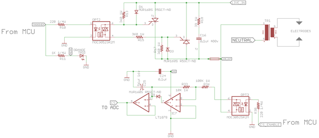

Hi All,
I am trying to switch on a LOAD from its OFF state by detecting a change in the voltage. Here the load is a MOT, the voltage at the primary is 1VAC when OFF.
My idea is to switch ON the MOT by detecting the voltage change at the primary when the Secondary are shorted. I can see a voltage drop of .5VAC when shorted. How can i monitor this voltage change with an Arduino.
My solution to the problem is shown below.
The Live of mains is connected to the MOT through the LIVE_LOAD in the schematic. During the OFF state the Optocoupler is triggered so that the 1VAC is seen by the Precision rectifier LT1078 and is rectified and send to the Analog pin A0 on the Arduino. With a code i could detect the voltage change and use it trigger the MOT again and at the same disable the optocoupler to break the circuit to the LT1078. Basically eliminating the need to press a switch two switch ON the MOT.
is there a better way to get this done. I was thinking of using the basic 1N4007 to convert the 1VAC to dc but that would be a problem when the MOT is switched ON allowing the mains 240VAC to flow through the DIODE.

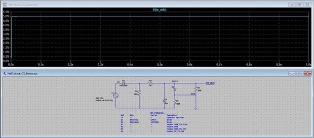

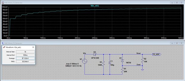

    1.3 V rms rectified is 1.8 Vdc minus the drop in a lightly loaded Schottky diode of 0.3 V is 1.5 V dc peak. The zener on the Schottky diode output is just to clamp the signal so it doesn't exceed your…

    The question (and the circuit) is not understandable I think : ( Could you rephrase the question, or draw a block diagram? The circuit doesn't make sense.
    0 jw0752 over 8 years ago
    Hi George,
    What does "MOT" stand for.  Also perhaps you could provide a little more information. At least to me it was not clear what you are trying to do. You refer to a LIVE_LOAD  and an LT1078, neither of which I can find in your schematic.

    MOT is short for Microwave Oven Transformer. i guess you did not click on the image to view it. The Live_LOAD is on pin4 of the optocoupler. LT1078 are the two opamps. A dual opamp.

    Thanks for your clarification. I have added your acronym MOT to my list. I saw the LIVE_OUT but did not associate it with LIVE_LOAD_OUT. I missed seeing the LT1078 when I clicked on the image. I assume that you are not driving a transformer directly with the MOC3052's 300mW max output. This looks like a very interesting question and I hope to learn from how you or one of the better engineers resolve it.

    Obviously not. The MOT is driven by the MOC3052. The MOT is driven by a pair of SCR in a Back-to-back configuration.

    The question is simply an auto-switch ON for a MOT that i had in mind and now as a schematic seeking second opinion from the pro's.
    The CS enable on the optocoupler is connected to an Arduino which is used to switch on and off the circuit that senses the state of the LOAD. The other side is the part is a precision rectifier that rectifies the 1VAC to DC so that the Arduino can work with it.
    Hope this adds more clarity.

    Obviously you need to be careful connecting directly to 220V and presumably you have the high voltage implications figured out and how to connect the low voltage supply - as in the whole circuit and its power supply needs to be enclosed with no possibility of human contact.

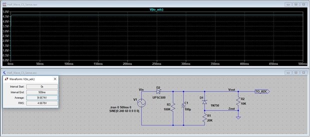

    You can limit the high voltage on the sense line with a zener diode, if you don't want to disconnect it.
    A Schottky diode is enough to rectify the sense signal, followed by an RC filter.

    Thanks for the concern. yes am well cautious about the mains supply and working with them.
    The least nominal voltage for a zerner diode is 1.8v which is quite high for the application. The OFF state voltage is only about 1.3vac max and i presume they are to be placed in series with the LIVE_OUT. A schottky would have a voltage drop as well.
    I guess the initial design would be ideal as the voltage drop across the diode is also compensated and being an opamp with slew rate of 0.1v/us i should get quick response as well. I could omit the capacitor as that would take time to charge during voltage variation and maybe the diode as well to cut cost or may be both. All i need is to monitor ANY change in the voltage so without the diode and the cap they should be ok.

    0 mcb1 over 8 years ago
    I think the question that everyone is stepping over is :-
    What is the voltage at the Live_Out pin when the MOT is turned ON.?
    As drawn I can't see how this schematic will provide what you want. (As I understand it)
    The detection circuit (LT1078) can't do any detecting until the Opto-coupler is turned ON by the CS_Enable line being driven High.
    It seems to me that you should be detecting the full AC voltage across the MOT and doing your signalling based on that.
    If you're trying to detect a shorted secondary, then measuring the primary current may be a better option.
