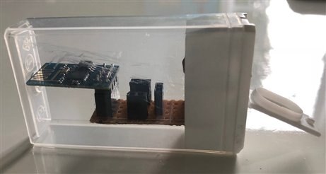

    But you don't actually need a Uno for it.
    I'm currently using one as a data logger, standalone, in a little tictac case:
    The biggest limitation is that it only has one easy to use GPIO pin. Two with a little more effort, and I think 4 with a fair bit more effort.

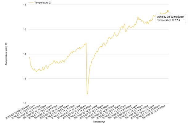

    I'm just using it with a Dallas 1-wire temperature sensor, and it calls a simple php script on my server that updates a basic text file. With a bit of magic, I'm getting real-time graphs of the temperature I'm tracking. I just put that together last night - went quicker and turned out nicer than I had intended!
    ps, the dip in temperature is when the heater and datalogger got unplugged for 25 minutes. Oops! but it was easy for me to detect and fix (ie, plug it in again), due to this data logging!
