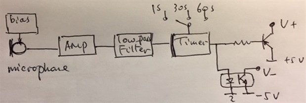

    Sorry my bad I am trying to cultivate my robotic engineering skills soo....
    the circuits are two different parts for the same robot but currently separated for prototyping

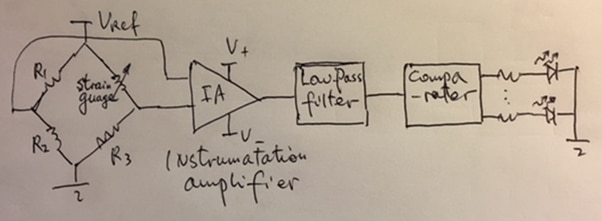

    part 1 (is a force sensor interface with signal conditioning for a robot hand):
    instrumentation amp of IN126, Low pass filter (20Hz) for noise, comparators (using LM324) for force levels 0, 20%, 40%, 60% and 80%.

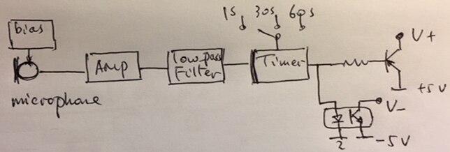

    part 2 (is a "sound wake-up robot"; creating a module to activate a robot from sleep-mode for power saving via a sound ‘trigger’. ):
    powered by 12v battery......
    1. The sound trigger will switch on other parts of the robot circuits, which consumes a maximum of 2A continuously current.
    2. The sound trigger shall be of the level of a normal human speaking voice at a distance of 1 metre. It will be desirable to arrange to reject frequencies outside of those intended for operation.
    3. Once activated by the sound trigger, the robot shall be maintained in active mode for a pre-set period. The pre-set period shall be ‘factory selectable’ to a period of either 30 seconds or 60 seconds so that the robot will go to sleep mode again when there is no sound within the period. For testing, it would be advantageous to also select a time period of 2 seconds.
    just have no idea of what an exact circuit would look like for both parts
    sorry still new to all this......

  • rusgray
    0 rusgray over 7 years ago in reply to the_future
    No offense intended, but you're asking for a lot. Circuit design isn't simple; that's why electrical engineering programs exist (It takes years to learn all the material needed to design circuitry.) I see from your profile that you're still in school, and not even to the high school level yet, which likely means that you lack the knowledge of mathematics and physics required to understand many electrical engineering topics.
    The best advice I can give you is to be patient and start very small. You have several blocks in your diagrams labelled "low-pass filter"; designing one of these is an excellent place for you to start, as very simple LPFs can be made using only two passive components. Once you've designed each block in your diagrams, you can start thinking about how to combine them.
    • Reject Answer
