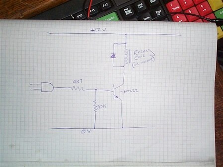

    quite funny really, I was using the 2N2222A2N2222A yesterday to drive 12v relays with a 5v signal from a TTL And gate image
    I used a 4k7 to feed the base and the base also had a 20k pull-down resistor (so nothing bad happens if I pull the AND chip).
    I`m thinking that IF the transistor is ok, could the Back EMF protection diode be forward biased?

  • YT2095
    0 YT2095 over 14 years ago in reply to Anonymous-58970
    No, I haven`t drawn one yet, but I can do if you like, I`ll probably post it in my Blog when I do a write-up for my latest Robot build, it`s very rare that I actually write any of my circuits down to be honest.
    also 4k7 is just the same as 4.7k (4700 ohms), I just write it that way out of habit image

  • YT2095
    my circuit works perfectly with the 4k7, I`v just drawn it out for you here:
    it`s not perfect and may need magnifying a little? but it works great (I have a board with 8 of these on that have been working well for nearly a decade), so this same CCT will also be suitable for the Original post, just swap out the Relay coil for your motor, and the AND gate should be the arduino pin.
    I`m using 12v on mine as that`s what the relays needed, but 5V will work too image
