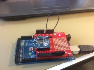

    Former Member over 12 years ago in reply to Former Member +1 suggested
    Hello Sriramreddy, You have to use X-CTU itself.But you have to put the arduino in RESET mode while configuring the XBee. This is done by connecting the RESET pin of the Arduino to its GND pin. From the…

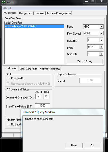

    Hai
    even i am working on the same issue but iam using Xbee S2 connected to Arduino mega 2560  where i am facing problem in configuring Xbee as acoordinator;can you please provide me the connection layout and firmware you used in your configuration. when i am trying to configure using X-CTU it am getting unable to connect with modem:can you please help me how you configured the Xbee as coordinator.

  • Former Member
    0 Former Member over 12 years ago in reply to Former Member
    Hello Sriramreddy,
    You have to use X-CTU itself.But you have to put the arduino in RESET mode while configuring the XBee. This is done by connecting the RESET pin of the Arduino to its GND pin. From the picture it is clear that you haven't done that.

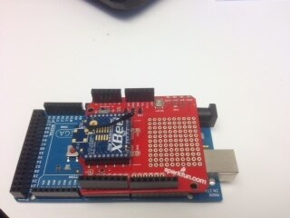

  • Former Member
    hai
    As per your suggestion i have tried cofiguring the xee node using Arduino mega 2560 by connecting rst to gnd. but i am getting the same error can you please show me your connection layout and the Xbee parameters for router and the coordinator.here is my connection layout  and the error as a picture.imageimage
