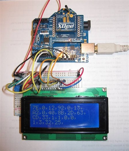

Hello all,

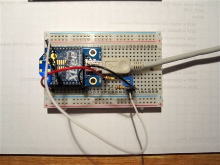

I am using two Xbee S2 modules to remotely sample analog data from a potentiometer.  Here is my configuration.
The local Xbee is mounted to an Xbee shield on an Arduino Uno.
The remote Xbee has a potentiometer feeding voltage (0 to 1.2V) to Analog Input Zero on the Xbee (pin 20.)  The USB cable is just for 5V power.
The code is listed below.  The problem is that many of the data frames (frame type 0x92) that I get back from the remote are corrupted or otherwise wrong.  I can use the checksum to drop the bogus frames on the floor, but they do make up about 50% of the frames I receive.  Are other frames being sent by the remote Xbee, i.e. status or error frames, or something else?  Is this normal?
The local XBee (coordinator) is programmed separately in API mode; the remote XBee is programmed separately in Transparent mode (AT commands.)  Since I do get occasional correct frames of data, I think the XBees are programmed correctly
When I do get a good frame, the data in it is correct as you can see in the first picture [Ref. 2, pg. 114].
Can anyone help me out with this?

  • Nate1616
    0 Nate1616 over 13 years ago
    Hey Kevin
    I know this is a dumb question but i have seen this before but does the baud rate on the xbees match the rate in the sketch.  If the rate is higher on the xbess then you will be sending faster than what can be processed.
    Nate

  • fidelsalinas
    0 fidelsalinas over 13 years ago
    Try updating to the latest digi firmware, then flash both xbees with the same firmware (API Mode Parameter D1 to D2 and Parmeter IR to "1000"  which will broadcast every 4096ms.
