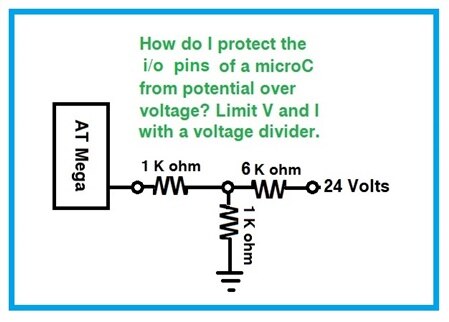

  • billabott
    0 billabott over 13 years ago
    May I suggest the following:
    0 mcb1 over 13 years ago in reply to billabott
    I think the OP wanted to control a 24v item.
    This is a very good referemce for anyone wanting to measure a 24v voltage.
    One thing that you might see on some circuits is a diode at the pin of the micro that has its anode connected to the supply.
    This makes sure the voltage at the pin can never be more tha 0.5v higher than the supply  ...which strangely fits within most IC specs.
    Of course this theory is only any good if the series resitor is in place otherwise the supply could get driven upwards.
  • billabott
    0 billabott over 13 years ago in reply to mcb1
    You are talking over my head with that diode idea.   The senario as I understood it was that how best to safeguard the microC in case the NFET shorted out completely.  So, Mark, are you saying that there are good reasons to also add the diode you mentioned in addition to the voltage divider in my illustration?  Most NFETs need very little V+I  at the gate to turm them on, but, I aslo believe opto-isolators are a great way to go.
