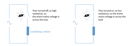

    If you're switching a large load, then it's good to switch it on at the point when the voltage is at zero, so that there is no spike in current which generates noise. That implies that the (b) method may be better.
    The other complication is that if the load is inductive, then the current through the load is not in phase with the voltage. So, when the triac switches off (i.e. when the current has dropped below the threshold for the triac), actually the voltage may be quite high. When the triac is on, the voltage across the triac is low because the load sees it (the triac resistance is low when on, so the voltage across the triac is low).
    (Edit: added this quick diagram to explain this):
    When the triac switches off, the voltage is across the triac (since it is no longer across the load, since the triac resistance is now high as a switch) and the fact that the voltage went from near zero across the triac to a higher voltage (due to the load being inductive) means that there was some dV/dt rate, and unfortunately large rate of change of voltage with time (i.e. dV/dt) kills triacs. This is the figure 14 from the doc mentioned earlier, where you can see that that the triac remained conducting (i.e. voltage across it was low) even after triggered, and even after the zero crossing, because the current was not in phase. When the current dropped, then the triac experienced the high voltage, and you can see the dV/dt is quite sharp.

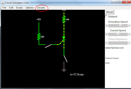

    0 shabaz over 13 years ago in reply to mcb1
    Ah, I think I know where William is going with this! Something like a normally-on microswitch to cut the power when the arm reaches a limit maybe? :-)
    Btw, you might like this site if you've already not seen it. I'm not super-familiar with the site, but it's nice to see the circuit simulated (and animated), so if you click on the link to go to the applet (needs java), then it opens up a new window like below, and if you click on Circuits->Misc Devices->Silicon Controlled Rectifiers->SCR (which for DC is close enough  and will work for DC as will a triac) then you'll see a circuit where you can click on the switches to turn them on and off. You could also modify the circuit, since it is a complete simulator, by right-clicking anyhere.
    But for low voltage DC control, nothing beats the MOSFET, since it can switch lots of amps, and may be cheaper and smaller than triacs. The only problem is that most are surface-mount, but I remember someone finding some TO-92 packaged ones. I'll see if I can find the name. The discrete mosfets are good for controlling power in one direction, but for two-direction then the circuit does start to get big, so an IC becomes more practical. Recently I used an IC for the control, and used it to switch four external mosfets, using MC33033 (old IC, but still manufactured and quite nice - it's designed for brushless motors, but it can be used with DC motors, shown in figure 45 of the datasheet).
