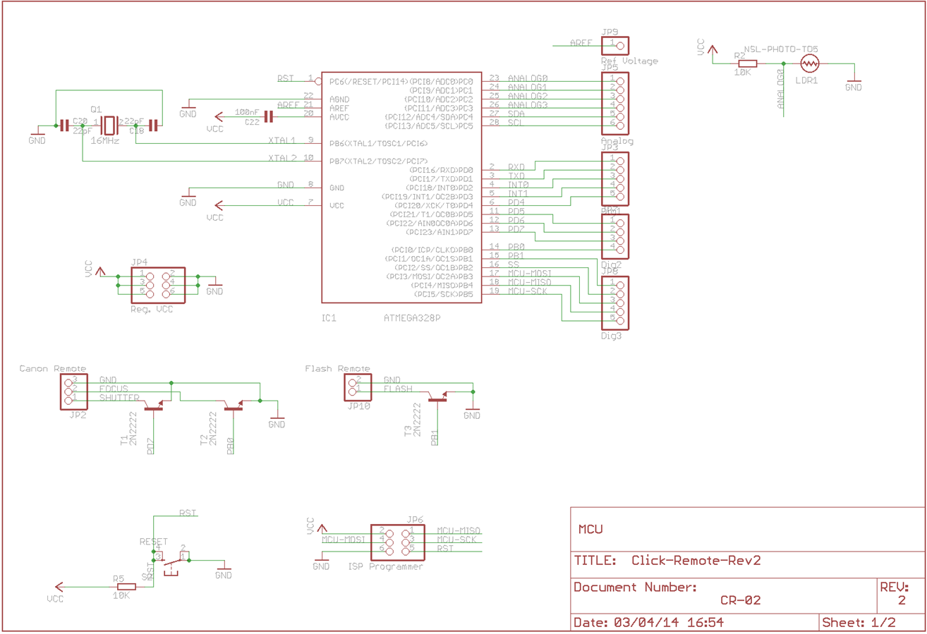

    0 balearicdynamics over 9 years ago
    Hello Saurabh!
    As all the other user friends says, that answer is yes you can ! There are a couple of things that maybe useful for you in the specific case. I don't know what kind of projects you have in mind (maybe a good idea to share them with us ?); We assume that it is really super-easy to make your arduino board - IMHO the absolutely easier is just the Paperduino project creating an Arduino compatibile board on a piece of paper image
    Then maybe you make things more easier for your specific projects. Instead of making the general purpose Arduino board with the advantage to be able to recycle indefinitely the board you can make for less than the cost of the commercial Arduino your own dedicated Arduino-like boards. 100% compatible with Arduino you can integrate the base circuit of the microcontroller with your dedicated components excluding all those parts that are not useful for you. The result is that you can obtain a Arduino compatible board running on your project, something original just done by you.
    Here are some examples I have used in past:
    TiltPan Micro Camera is up and running !!!
    Microcontroller Health Status Controller Board based on AVR328p
    The following is the schemits of another Arduino dedicated board. I hope this suggestion maybe useful, if you need more information let me know.
    Enrico
