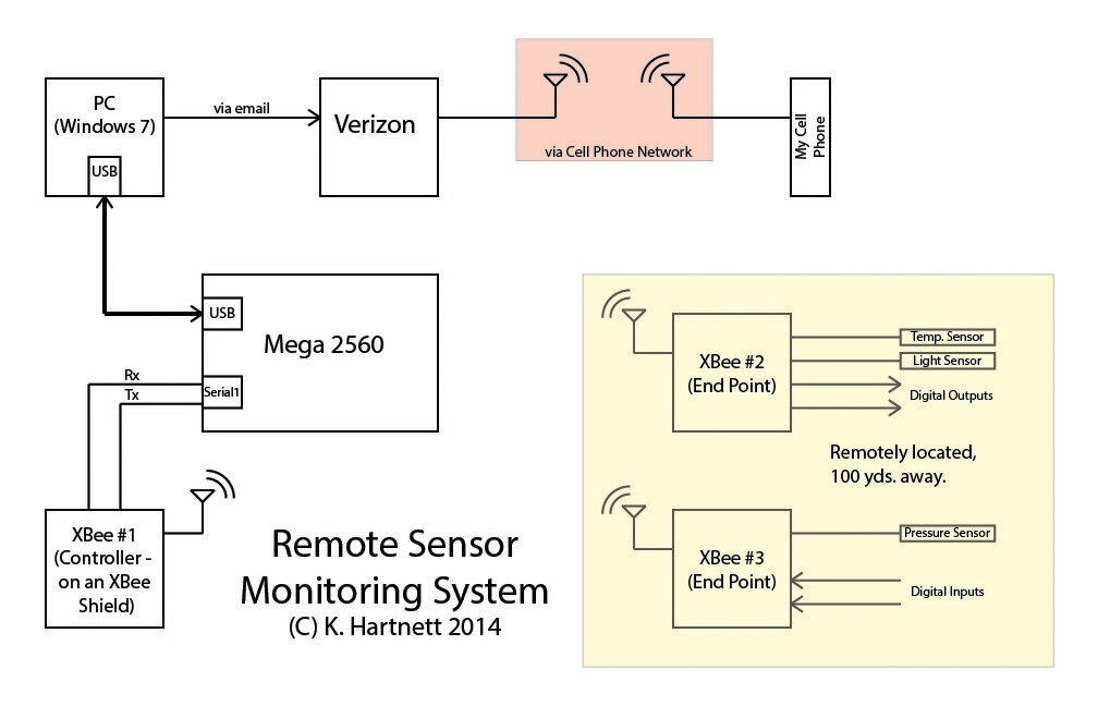

    kjhart0133 over 12 years ago in reply to Robert Peter Oakes +1
    Peter, That's great info about the ports. I'm learning a lot in this thread. Here's a block diagram of my system that shows all the components. I run Processing code in the PC that uploads data from the…

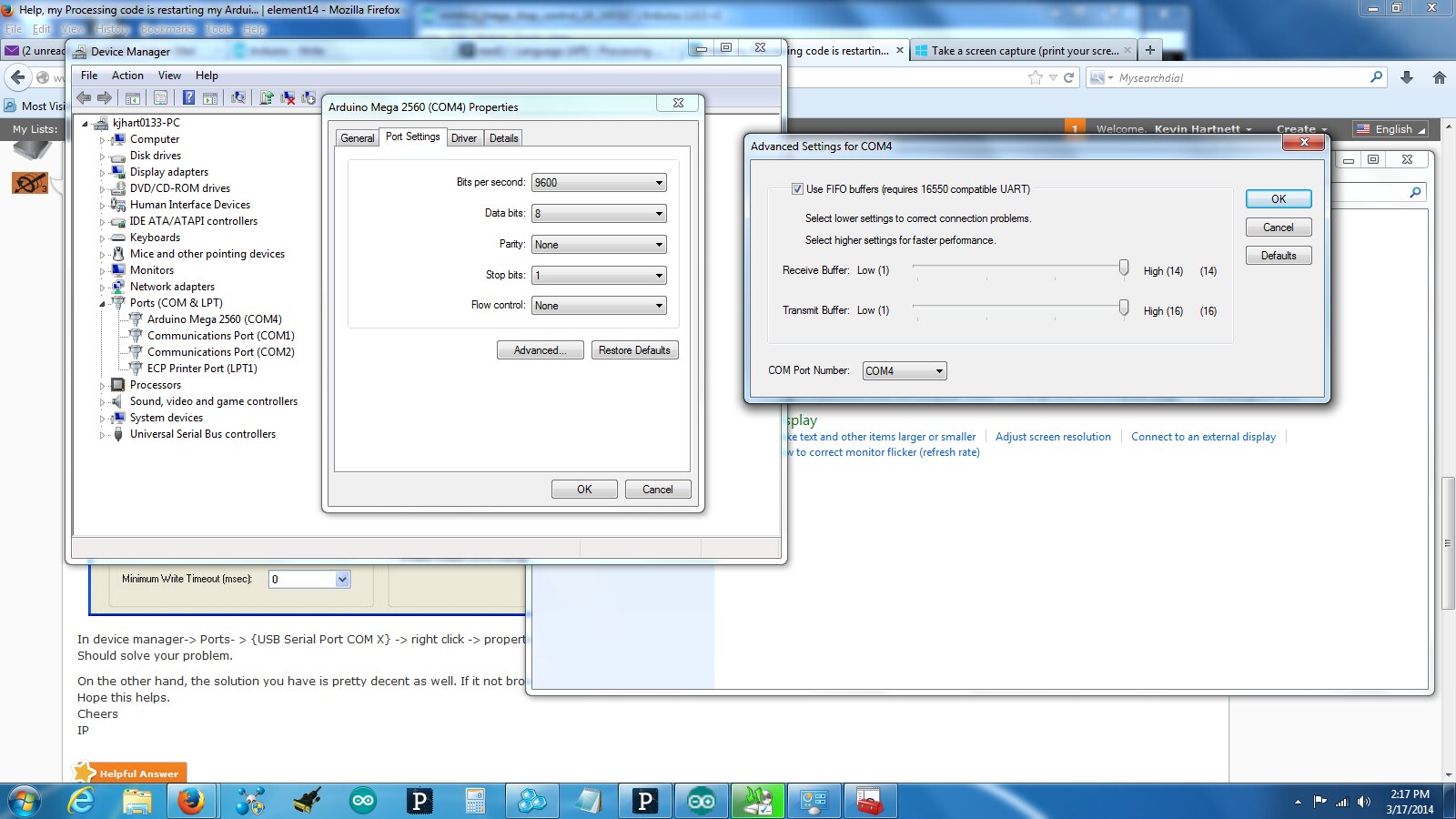

    0 kjhart0133 over 12 years ago in reply to ipv1
    Mr. Singh,
    1.  I had no luck using the technique of holding down the reset button and trying to release it at just the right moment.  Never could get that to work.
    2.  re: disabling DTR/CTS in the Device Manager.  I followed your instructions but didn't find any popup that allowed access to DTR/CTS control.  I'm using Windows 7.
    I continue to fool around with this, but for now I just installed a switch across the reset solder pads and it seems to work.
    Thanks,
    Kevin H.
  • ipv1
    0 ipv1 over 12 years ago in reply to kjhart0133
    The reset when uploading should have worked but no issue.

    In device manager-> Ports- > {USB Serial Port COM X} -> right click -> properties-> [TAB] Port Settings -> [BUTTON] Advanced Settings-> Set RTS on close.
    Should solve your problem.

  • kjhart0133
    Sorry, IP, we must have different versions of Windows.  I don't see the screens you show.  I'm using Windows 7 and I get the following screens when I follow the path you indicate.  I hope you can read it, but it doesn't provide any control of the serial functions I'd need.  There's surely another way, but everything is working well now, so I'll probably leave well enough alone.
