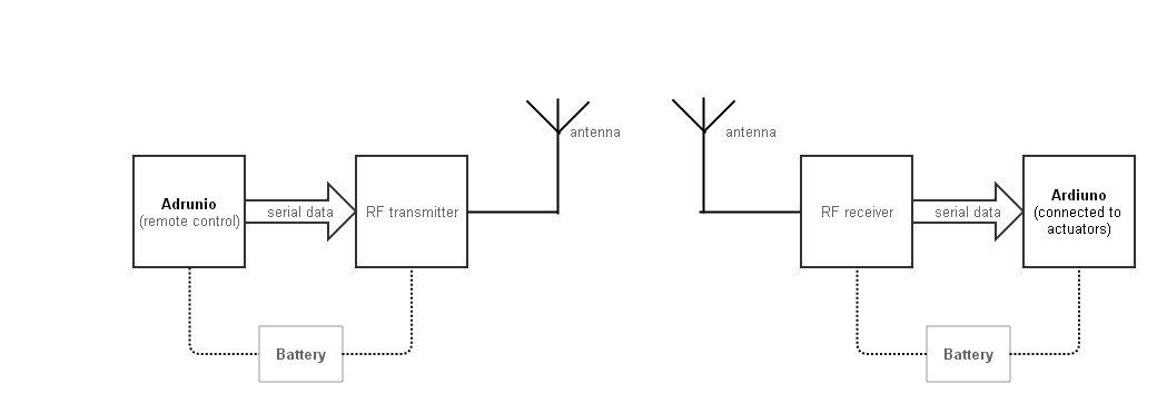

I just started using the arduino and tried to build a remote control car. I have used the 434MHz RF module for radio transmission. I made a program for both remote and the receiver in the car, it worked fine when I tested it using my pc to send and receive signals. since I used the serial communication, it didn't work when I disconnected the arduinos from my pc. Is there a way to use the serial communication even when it is not connected to the pc, if it can be done, please suggest a way to do so.

    There are many considerations to take in account:
    -instead of using "serial.print" which is a display command, try using "serial.write" to transmit data (http://arduino.cc/en/Serial/Print#.UyoIPIXPsvw)
    -have you used the virtualwire library?
    -it's well known that cheap 434MHz rf modules are "what you pay is what you get" so you might aswell get delays and corrupted transmission from them even with the increase of the length of the antenna, when you have obstacles and interference. Don't expect large distances operations, these modules work in amplitude shift keying for low performance applications (http://en.wikipedia.org/wiki/Amplitude-shift_keying)

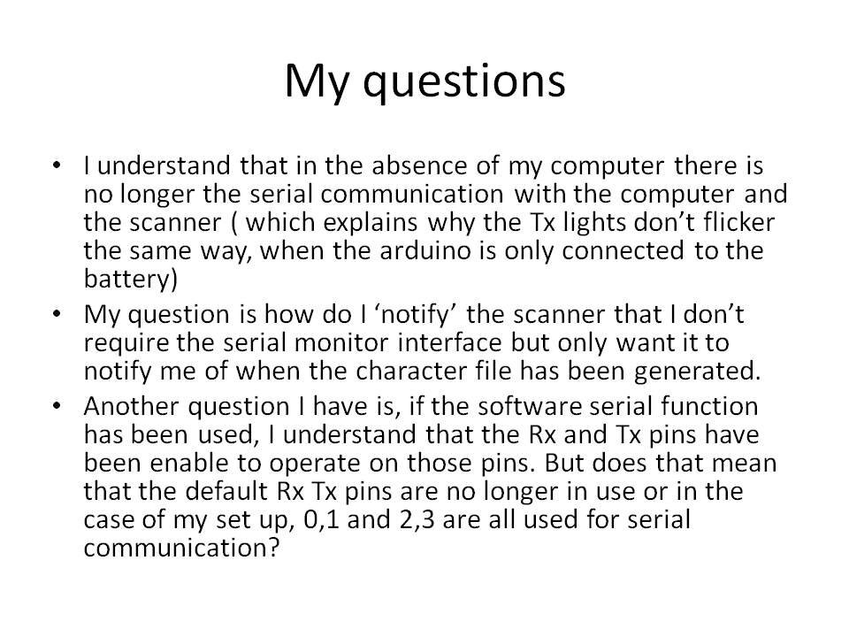

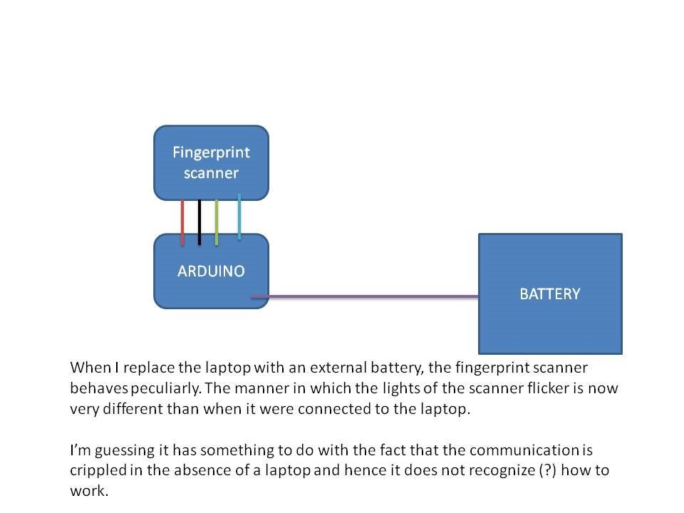

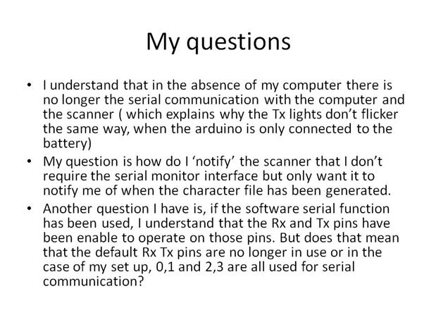

    Hi,
    Sorry, I'm quite new to the arduino( and electronic) platform, so apologies in advance if my queries seem silly.
    But does that mean i would need to replace the serial.print commands with serial.write or since I would no longer require the laptop interface, can I just get rid of all the serial.print commands in my code?
    I am working on getting rid of my laptop interface and just uploading the code onto my arduino board. unfortunately, even after getting rid of all the serial.print commands while retaining all the other essential parts of the code, I dont seem to have it working without the usb to pc connection.
    May I know what I'm doing wrong? Am I expected to ADD certain code now ( like the serial.write command) into my code now?
    Many thanks for any help with regard to me query! image

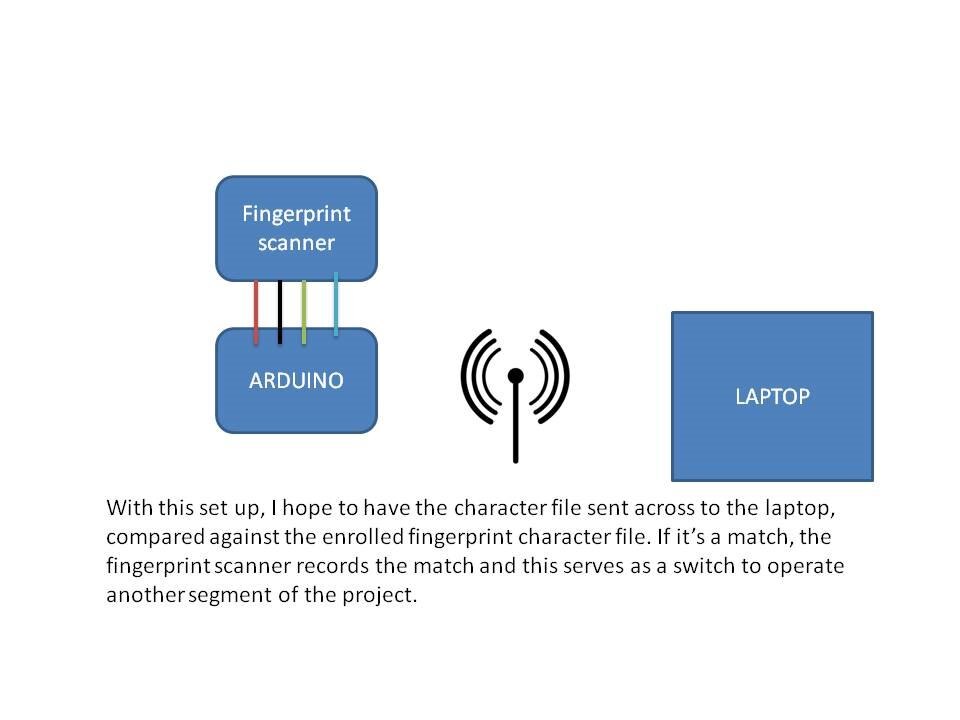

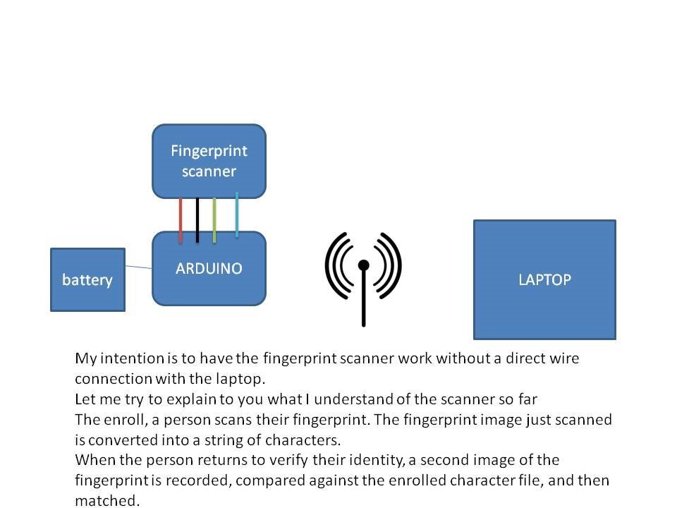

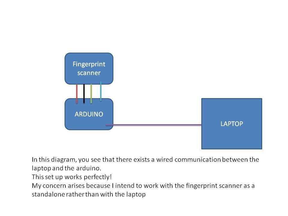

  • elizabethmath
    0 elizabethmath over 9 years ago in reply to neilk
    Hi,
    Thank you so very much for taking time out to assist me with this. I really appreciate the help!
  • elizabethmath
    0 elizabethmath over 9 years ago in reply to Robert Peter Oakes
    Hi,

  • elizabethmath
    Hi Mr. Oakes,
    The problem is that neither of the led lights signalling Rx and Tx communication flicker when the system is not connected to a laptop.
    I think thats the part I'm having most trouble figuring out.
    With the voltage supply, I have tried both the barrel connector for the 9v battery as well as connecting the 9v battery supply into the Vin pin. I get the same response from both.
    I also tried checking to see if the battery was supplying enough voltage as per the fingerprint scanner requirement.
    Using a multi meter, I established that the fingerprint scanner was indeed receiving between its allowed range of 3.66- 6 V.
    It was on these grounds that I ruled out a problem with the electrical set up.
    What are your thoughts?
    Do you think it could still be a problem with the power supply?
