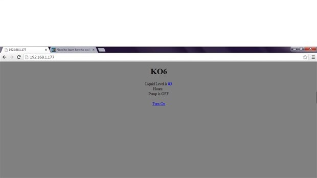

Hello,
     I am new to Arduino and I am having a hard time figuring out how to create a hour meter. I am using an uno with an Ethernet/SD shield. I have that hooked up to sump pump and a transducer. I am able to see the liquid level and control the pump via web page. However, I would like to create a hour meter that records the pump run-time hours, and prints it on to the web page. Here is my code,

  • Robert Peter Oakes
    0 Robert Peter Oakes over 12 years ago
    What do you get on the web page, provide a screen shot
    as for measuring the hours, when you turn on the motor you capture the current mills() to a variable, when you turn of the motor you subtract start mills from end mills and then add the difference to a run time counter (A "Double Runtime = 0;" declaration should do the trick), divide the difference by 1000 in order to simply track seconds if you want a bigger count.
    the extra thing you can do after that is to write the value to eeprom in order to survive a reboot of the PI, your start up code would read the eeprom value back into memory in the startup function

  • neilk
    0 neilk over 12 years ago
    As Peter says, what does your web page actually look like? Can you provide a screen shot?
    Neil

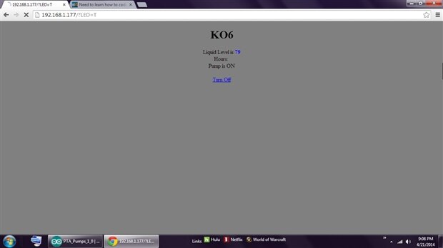

    0 e14 Contributor over 12 years ago in reply to neilk
    Thank you guy for your replies,
    I am going to tinker with the mills() as a variable this week and see what i can come up with.
    Here are two screenshots of the web page one is of the pump off and and one of it on.

    0 e14 Contributor over 12 years ago in reply to e14 Contributor
    I am newbie here but is the problem that you have put this line  " int onTime =+ runTime;" in the declaration section.  It is only ever read once by the program.  Should it not go into the loop()?
    I am still a newbie too,
    my theory was to declare "int onTime =+ runTime ;" in the begin so I could use "client.print(onTime);" when I want to out put the run hours on to the webpage.
    I tried " client.print(onTime =+ runTime);" in the loop but I still get a 0 reading .
    Scott,
    When you declare onTime in the beginning of your code, you are setting it to zero:
    //Declarations for the hour meter
        int startTime = millis();  <-- setting start time to current millis()
        int stopTime = millis();  <-- setting stop time (probably only a few microseconds later, depending on clock speed)
        int runTime =((stopTime) - (startTime))/1000;  <-- setting runTime to pretty much zero
        int onTime =+ runTime;  <-- declaring onTime and incrementing it by pretty much zero (also, I believe the increment should be += as opposed to =+
    After which, you do not do anything with onTime, other then printing it to the client, so it remains at zero.  You would need to do the math for calculating the current run time somewhere in the loop, probably after turning the pump off, or at a point in the code, you could get the millis() and subtract start time from that and set runTime to equal that, then increment the onTime after shutting the pump off.  In order for this to be a true cumulative timer, however, you will need to store this is some sort of non-volatile memory, otherwise every time you re-connect to the Arduino, or every time it loses power, you will re-set the variables.  I would also suggest getting rid of:
    if (digitalRead (LEDpin) == HIGH){ startTime = millis();  }
    if (digitalRead (LEDpin) == LOW){  stopTime = millis();  }
    And moving the startTime = millis() statement to the same if statement where you turn the pump state to on, and the same with the stopTime, except moving it to where you turn it off:
    if (readString.substring(LED,LED+5) == "LED=T") {
      digitalWrite(LEDpin,HIGH);
    state = "ON";
    else if (readString.substring(LED,LED+5) == "LED=F") {
    digitalWrite(LEDpin,LOW);
    state = "OFF";
    stopTime = millis()
    This is just to help get moving forward.  You may want to hard-code values into some of your variables for debugging, just to see if you can get a value to display for time.  One important question though, do you plan on ONLY running the pump while connected to an Ethernet client?
    Hope this helps

    0 e14 Contributor over 12 years ago in reply to Robert Peter Oakes
    this is what I came up with:
    [code]
    if (digitalRead (LEDpin) == LOW ){
              else if (digitalRead (LEDpin) == HIGH){
             onTime =+ runTime;
    [/code]
    This has seemed to make it work, "kind of"
    when it turns on it starts counting and when it is off it stops. that part is perfect, how ever it will only count up to 30 and then count backwards to -30 and then back to 30.
    I am really confused on this one lol
