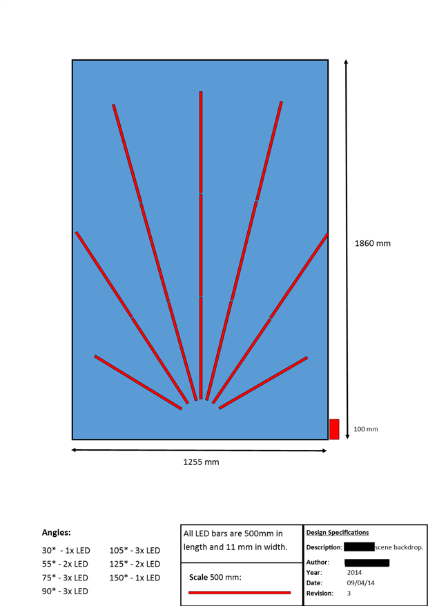

One of the directors has asked me to create a special backdrop for our college musical. This particular backdrop has a particular design (see below) that includes LED strip lighting to give the feel of a 1920s casino sign – similar to what is seen today in Las Vegas.
I  have done up a detailed design for this sign, based off the rough sketch given to me by the director and the dimensions of the backdrop.  On this diagram, the arrangement of the LED strip lighting can be seen.
The LED Strip lighting that will be bought for this project will be sourced from Jaycar – “Low Cost 5m Flexible Adhesive LED Strip Light – Warm White” (ZD0577).  According to the specifications off Jaycar’s website, these LED lights need 1.1 Amps per metre @ 12 volts.  This means that the longest segments of lights need 1.1 * 1.5 = 1.65 Amps of power (rounded up by 20% for safety: 2.0 Amps @ 12 volts).

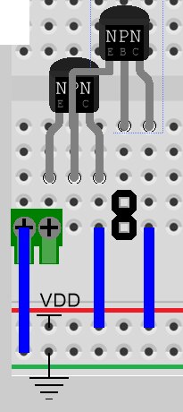

This would not be an issue if I was just turning these LED Strips on and off with mains power BUT I want to control these LEDs via an Arduino, so that they can do fancy things like flash and chase.  That means that I would need a circuit to control these lights with an Arduino so that everything remains safe and does not blow up.
I have come up with this circuit (below) using a couple of NPN transistors and two power supplies.  In the diagram below, I am aware that the transistor pinouts are EBC.  The ones I am going to buy have a pinout of BCE.
The only problem with this is that I have very little understanding of transistor circuits.  What this circuit has to be able to do is:
  • Using the smallest amount of current from the Arduino (at 5 volts) or a Raspberry Pi (3v3 volts), turn on the circuit to allow the 12 volts that powers the LED strip lighting to flow.
I was thinking of using either TIP41C NPN Transistors (in a darlington Array) or TIP122 NPN transistors.
This circuit will be replicated 8 times over to accommodate for the number of LEDs I am controlling.
Can anyone help me:
  1. Design a circuit that will work 100% and will be safe (ie: low heat)
    1. This includes base resistance
  1. Confirm which transistors I should be using for this project.
Any help will be much appreciated.

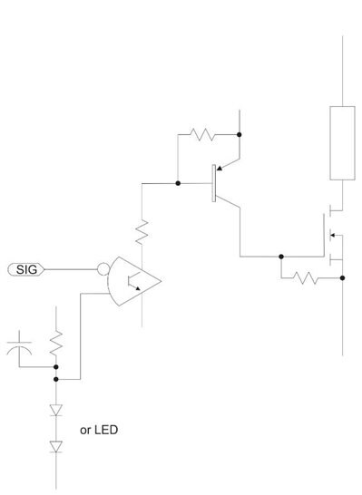

  • D_Hersey
    D_Hersey over 11 years ago +1
    Solenoid Whapper:
  • Problemchild
    0 Problemchild over 11 years ago in reply to mcb1
    Just shows you that it's just a case of getting the right search terms to finding something in EBAY!
    0 mcb1 over 11 years ago in reply to Problemchild
    Yes it can.
    I generally don't use eBay because the vendor may or may not have the part, it is sometimes more expensive, and I generally want to repeat the purchase.
    However that's a personal choice, and shouldn't stop anyone else.
  • D_Hersey
    0 D_Hersey over 11 years ago
    alterna banger:

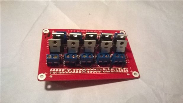

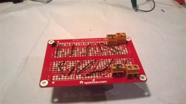

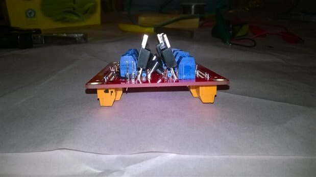

  • wallarug
    0 wallarug over 11 years ago
    Board is built and tested with 5 volts and 9 volts - no issues thus far.
    I am going to conduct further testing tomorrow.
    Images below:
    Quick Question:

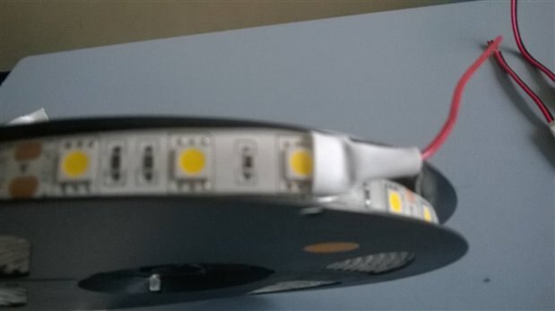

    1.  Do the LED strip sections need to have the pads shorted in order for the lights to work?
    When I first tested them, it seemed that I had to have a wire across the top + and - metallic pad to get it to work.  Yet when I tried it a second time I didn't need it?  Any ideas / experience?
    LED Strips: see metalic pads.
    BTW:  I have not yet added in the NPN base resistor, I will do that tomorrow.
  • wallarug
    0 wallarug over 11 years ago in reply to wallarug
    Hey Guys!
    I forgot to thank you all so much for your efforts in this project.  It worked BRILLIANTLY!!  The Director and the audience were amazed at such a wonderful set backdrop.  It could not have been done without all of your help.  Special thanks goes to: John Alexander, Douglas, and Peter.
    Here is a video of the set backdrop while we were testing it.
    ...and one of it on the stage with the other production lights on ( 9 x 1200W pacifics + 6 x LED PARs ).  From this video you can see it was VERY VERY bright.
    Once the production was complete, myself and a friend decided to attach a Raspberry Pi to it and using the 'lightshowpi' software were able to sync the LEDs to the music.  Very fun indeed.  The board did not break at any stage.  The temperature off the board (MOSFETs, etc.) was not noticeable even under such stresses put on it by the software.  The videos of that are on the same youtube channel (cmdenterprises) if you have some time to enjoy them.
    I hope to do a write up on this project one day so that others can do similar projects or learn by doing like I have done.
    Thank you again to everyone on E14 who made this happen.  You left a lot of people amazed on show night!!
