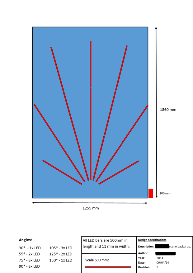

One of the directors has asked me to create a special backdrop for our college musical. This particular backdrop has a particular design (see below) that includes LED strip lighting to give the feel of a 1920s casino sign – similar to what is seen today in Las Vegas.
I  have done up a detailed design for this sign, based off the rough sketch given to me by the director and the dimensions of the backdrop.  On this diagram, the arrangement of the LED strip lighting can be seen.
The LED Strip lighting that will be bought for this project will be sourced from Jaycar – “Low Cost 5m Flexible Adhesive LED Strip Light – Warm White” (ZD0577).  According to the specifications off Jaycar’s website, these LED lights need 1.1 Amps per metre @ 12 volts.  This means that the longest segments of lights need 1.1 * 1.5 = 1.65 Amps of power (rounded up by 20% for safety: 2.0 Amps @ 12 volts).

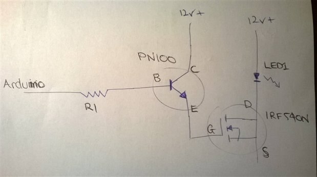

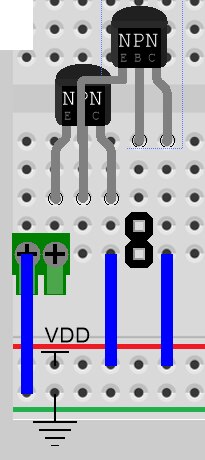

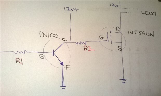

I have come up with this circuit (below) using a couple of NPN transistors and two power supplies.  In the diagram below, I am aware that the transistor pinouts are EBC.  The ones I am going to buy have a pinout of BCE.
The only problem with this is that I have very little understanding of transistor circuits.  What this circuit has to be able to do is:
  • Using the smallest amount of current from the Arduino (at 5 volts) or a Raspberry Pi (3v3 volts), turn on the circuit to allow the 12 volts that powers the LED strip lighting to flow.
I was thinking of using either TIP41C NPN Transistors (in a darlington Array) or TIP122 NPN transistors.
This circuit will be replicated 8 times over to accommodate for the number of LEDs I am controlling.
Can anyone help me:
  1. Design a circuit that will work 100% and will be safe (ie: low heat)
    1. This includes base resistance
  1. Confirm which transistors I should be using for this project.
Any help will be much appreciated.

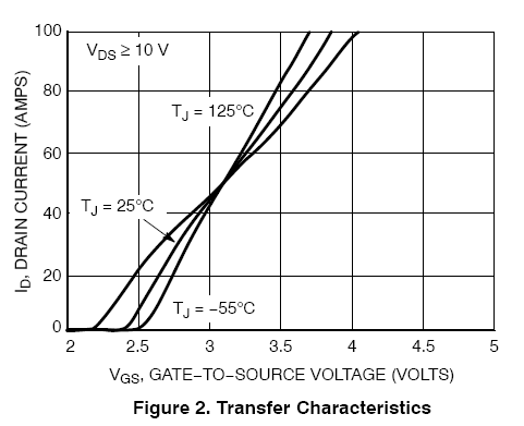

    John If you are referring to this It means that at a gate voltage of 1.6 typ, a current of 250uA will be flowing in the Drain. If you look here, you can see that from 3 to 3.3v will give you enough to…

    If you want to drive the strips easily then using a logic level FET will work the easiest for you
    something like this, a few K gate resistor would be all thats needed between the Arduino and the FET
    http://canada.newark.com/fairchild-semiconductor/fdp7030bl/n-channel-mosfet-30v-60a-to-220/dp/38C7149
    and with your loads they will not require heat sinks as the on resistance is only 0.009ohms so even at 60Amps thats only 0.6W so at 2 Amps its only 0.02W.
    now you mention running and other patterns, if your using all one color strips running on 12 V then the whole strip will be on or off, or using PWM any brightness in between
    if you use strips that have LEDs like WS2812B then you dont need drivers, they will work on 5V and you can make any LED be any color and intensity you like (Yes, every individual LED)
    AdaFruit sell them under the brand of NEOPixel https://learn.adafruit.com/adafruit-neopixel-uberguide
    you can also get LED strips that are RGB so you can change the strip color but all the strip will be the same
    either way, with the exception of the strips with the WS2811/12 LEDs, the FET I linked in will work easily for you
    0 dougw over 11 years ago

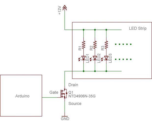

    You can avoid using resistors if you use a logic level FET instead of bipolar transistors.

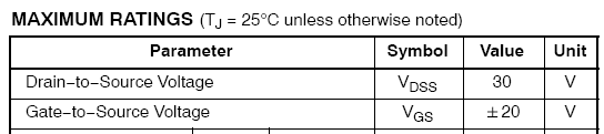

    The NTD4906N-35G is a low cost power FET that will not get hot at this current.
    This transistor will generate less than .025 watts of heat when driving 2 Amps:
    If you want to limit the transient current to the transistor gate you could insert a resistor between the arduino and the transistor - anywhere from 1K to 10K ohms should be fine.

    Your transistor solution doesn't have enough gain to drive them properly.
    I posted somewhere else here ... can't find it immediately
    Fets are a good idea. so follow Doug  and John

    It seems that the best option for this project is FETs (from the above feedback).  Douglas' schematic seems like the way to go except with only one LED strip in the circuit.

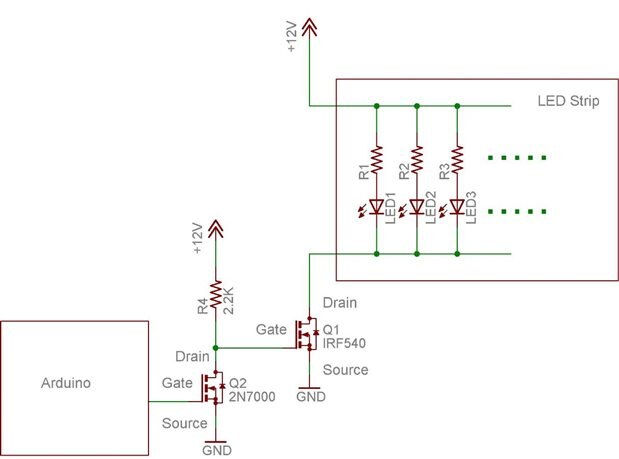

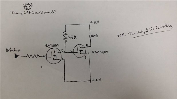

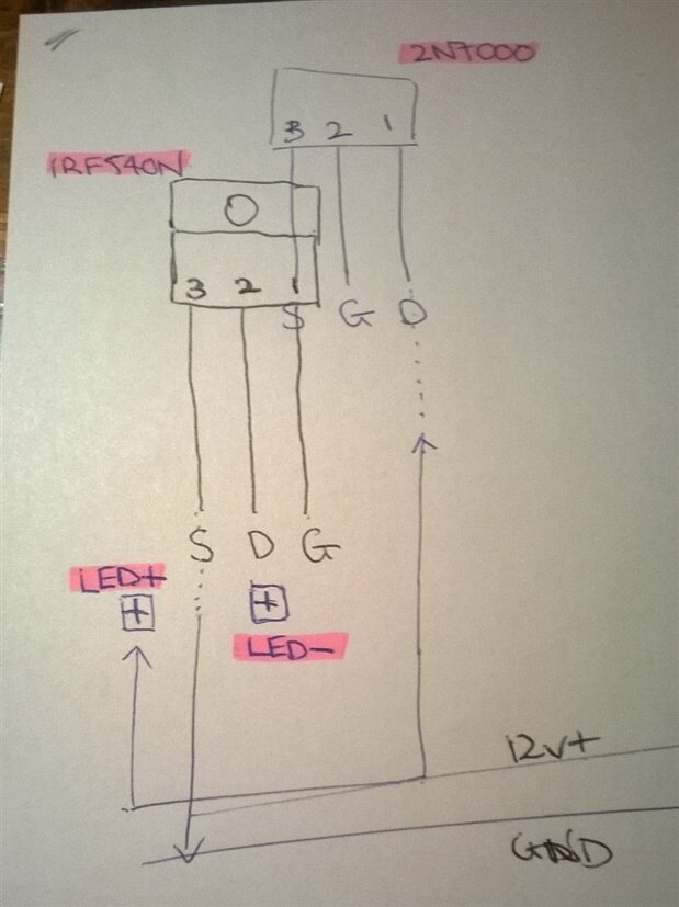

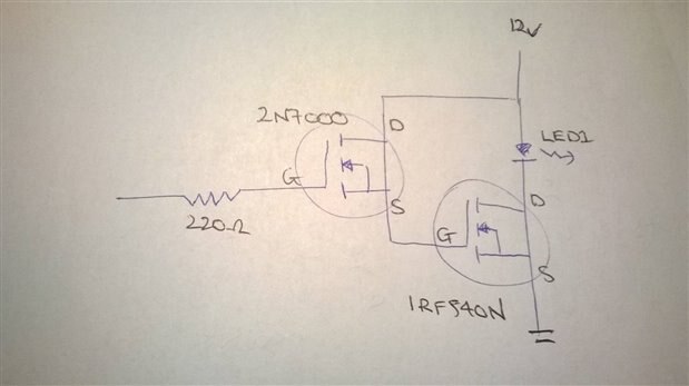

    Looks like the  choice isnt that great at least at the UK Jaycar you may consider going for the low power 2n7000 FET on the output of the Logic then have it switch the Gate of the bigger FETS they have using the available 12V supply.
    The few IRF transistors are more suited to 5V minimum........
    Doh .....Saw Arduino...
    IRF540 should be OK in that case
  • Problemchild
    0 Problemchild over 11 years ago in reply to Problemchild
    I'd try and get the part specified by Douglas if you could BTW as this looks like an Excellent part.
    Otherwise the '540 again if you are stuck with Jaycar only

    I think the 2N7000 is ruled out.  --> maximum current of 2 Amps drain.
    The IRF540N (which Jaycar AU supply) seems like a contender with maximum drain current of 33 Amps.

    0 Problemchild over 11 years ago in reply to wallarug

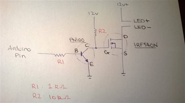

    The 2n7000 was merely a throw away to drive the gate of a bigger FET not for driving the LOAD directly
    1) Most probably use a bit of aluminum strip as a heat sink  for each of the FETs if you want to be safe
    2) Yep, Douglas is right ...this stuff is that easy!! The Gate of the FET is high impedance any way no real need for a resistor
    3)Bugger all image !! The FET is doing all the heavy lifting and all you need to do is keep the Gate On
    4) Consider the 2n7000 to drive the IRF540 then you can operate the gateof the '540 from say 12V and really turn the gate hard on, lowering the Rds(on) as much as possible decreasing the dissipation.
