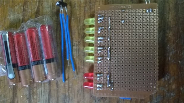

Hello,
Im currently working on my first real noobish project, its a temp/moisture sensor for my brother for his organic garden,
i have all my leds and 330 resitors soldered on, but i need to know waht componets i need to take 4 AAA batteries and power my chip without the Arduino,
everything can fit into the container i want it in (an altoid can) but i need to know what resistors/capactors or regukaters i need ino order to safely run my hardware.
also what ways can i use my multimeter so i can measure the volts and amps, so i can calculate how long the batteries would power the device.

    He's probably trying to run the chip by itself, with out the arduino board.
    Thing is that you'll have 6V and you only need 5V or less. To get 5V from 4 batteries you will need a LDO (voltage regulator with low voltage drop), however that's wasteful. A better approach would be to just use 3 batteries, which will give you 4.5V tops and run your chip from that - no regulator required.
    That aside, you will need decoupling caps on each VCC input (100nF ceramic caps), maybe an electrolytic cap too (of a few uF) across the rails and that's about it. Make sure you enable brown out detect, so the chip shuts down on under voltage - that way you'll know for sure that it won't start malfunctioning when the batteries run out.
    Another thing you might want to do is to increase the value of those resistors a bit. The less current you draw, the more your batteries will last.
    To get an idea about how long the batteries will last, you can measure the current consumption of your circuit and divide the mAh rating of the battery by that number. The real number will be smaller, since the voltage also drops as the battery is discharging and it will reach a point where you can't use it anymore, way before the battery is fully discharged. To get a better idea of how long the battery will last with your load, you can check the datasheet of your batteries, where you should find some discharge curves.

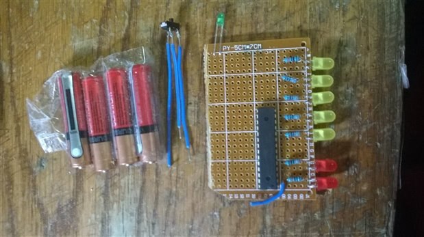

    ,here is my setup, and i want to power the chip with just 3- 4 AAA batterys

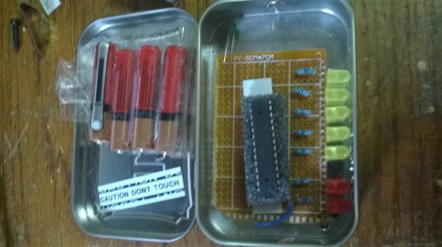

    I just know im going to get flamed by my community fellows for this but the simplest way of powering the whole thing from the batteries would be to simply put a couple of diodes in series with the battery, thereby dropping the voltage by 0.6*2 = 1.2V, maybe a bit less depending on the Diodes you use. This would then power your system with 4.8V on a new set of batteries and will simply drop from there as the batteries are discharged.
    Of course a better option is a low drop-out regulator to run at 5V but of course your going to have it fail before the batteries are discharged.
    Even better would be a Buck regulator powering your system at 3V3 instead of 5V. these are much more efficient than a low drop-out regulator or the diodes as your not throwing power away across the regulator/Diodes so your batteries will last much longer
    The only down side of running the system at 3V3 is that the micro-controller will need to run at 8Mhz instead of 16. But considering your project I don't see this as a problem
    Hope this helps regarding the power situation
    0 mcb1 over 12 years ago in reply to Robert Peter Oakes
    Peter
    Both suggestions are reasonable given the design.
    I think the 3v3 regulator is the best option, since it will give the longest run time.
    The third option is to use rechargeable batteries, as their voltage is 1.2v  (4 x 1.2 = 4.8v)
    Your design appears to not have a xtal/oscillator, so it runs at 8MHz anyway (page 33 of the ATmega 328 manual)
    You might need to load it using a different board, but there is some info here (change to 328)
    http://wolfpaulus.com/jounal/embedded/minimalarduino/

    Yeah get one of those regulators from ebay like this one
    Set it to 3.3V as stated else where, nice and cheap reliable too !!
    Best keep the clock rate down if you are using a 5V part like Mark said...
    0 e14 Contributor over 12 years ago
    I would recommend placing plastic backing on the Altoids tin, or spraying it with some material to keep it all from short circuiting.
    I guess you could use it as a ground, that would keep everything nice and neat.
