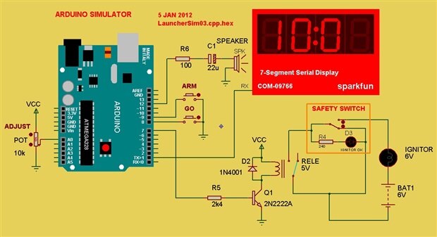

Hi, i'm new to arduino so i don't know much (yet image) but i'm working on an device for airsoft simulation that will light a pyro when the countdown hits 00:00
I saw a project on the internet and got the parts and code and it works.. but not quite in the way i would like it to.
First thing i would like to modify is the code that is already working. It uses a potentiometer to adjust the time to countdown (5s-60s) but i want to be able to count down from 10s or 9999s  10s being min time & 9999s being max time
Another thing is, the guy who wrote the code made it that only 3 digits are used but i would like to use all 4
I'm using a
7-Segment Serial Display - Red - COM-11441 - SparkFun  for the display
The code and schematic are posted below
If anyone can help me the would be much appreciated
Thanks

  • Robert Peter Oakes
    0 Robert Peter Oakes over 12 years ago
    First this is needing to be changed
    void ReadTimer(){
      DownCntr = map(analogRead(SetPot), 0, 1023, 5, 99);
      DownCntr*=10;
    to
    void ReadTimer(){
      DownCntr = map(analogRead(SetPot), 0, 1023, 10, 9999);
      DownCntr*=10;
    and change this
    void ShowTimer(){
      String minute = String (DownCntr, DEC);
      while(minute.length()<3)minute= "0" + minute;     //format to 3 numbers.
      mySerialPort.print(minute);                         //Write to Display.
      mySerialPort.print("0");                             //Last digit off.
    to this
    void ShowTimer(){
      while(minute.length()<4)minute= "0" + minute;     //format to 3 numbers.
      mySerialPort.print("0");                             //Last digit off. <-- this line may need to be deleted
    This should be enough from what I can see
    The display in the diagram is not connected to the same pins as the code indicates

    0 e14 Contributor over 12 years ago in reply to Robert Peter Oakes
    Hi, thanks for the reply.
    I changed what you said to and when i upload to the arduino the display flickers random numbers
    i also tried removing the line     mySerialPort.print("0");                             //Last digit off. <-- this line may need to be deleted
    0 Robert Peter Oakes over 12 years ago in reply to e14 Contributor
    what happens if you only apply the first fix ?
    I dont have your hardware so im trying to provide help through manual examination of the code ?
    Peter
    Random numbers scroll across the screen
    just tested using the serial console as I dont have a LED display like the one you have
    this works for the two functions (Thats all that needs changing)
    void ReadTimer(){
      //DownCntr*=10;
    void ShowTimer(){
      while(minute.length()<4)minute= "0" + minute;     //format to 4 numbers.
      mySerialPort.println(minute);                         //Write to Display.
      //mySerialPort.println("0");                             //Last digit off.
    be aware though that you are up scaling the reading from the POT now so a count of 1023 will give you 9999 (10* the pot reading), you will not be able to adjust to exact time setting but it works aside from that
    oh and you may well find the last 2 digits may ghange even though your not adjusting the pot, this is expected and normal due to the ADC reading slightly different each time and multiplying up the result
    I have uploaded the new code and the display flicks between d010 & 10d0  image
    does the orgional code work ok and do you have the display connected and set to use serial rather than I2C or SPI ??, because that seems to make no sence, I ran you code with the exception of changing the myserial print statements to output to the normal serial port and it works just great
    as in this (With my modes)

        delay(FuseTIME);
        delay(FuseTIME);
        digitalWrite(Fuss,LOW);        //OPEN the fuse circuit.
         Go=0;
      while (millis()% 100);        //Wait until the next 1/10 of second.
      delay(50);
      DownCntr--;
    void WaitGO(){
      ShowTimer();
      while(digitalRead(GoButt));
      Go=1;
      delay(20);
      while(!digitalRead(GoButt));  //Debounce GO button.
    void ReadTimer(){
      //DownCntr*=10;
    void ShowTimer(){
      Serial.println(minute);                         //Write to Display.
      //Serial.println("0");                             //Last digit off.
    void WaitARM(){
      while(digitalRead(ArmButt)==1){
         ReadTimer();
         delay(50);
         ReadTimer();
         ShowTimer();                   //Show Digits.
         delay(150);
      Go=0;
      ShowTimer();
      tone(BuzzPin, 2000, 150);
      delay(200);
      delay(200);
      delay(20);
      while(!digitalRead(ArmButt));  //Debounce ARM button.
    The original code set to 5-99s with 3 digits works and yes the display is setup using serial UART
    try the program i posted and see if it displays correctly over the serial port of the PC IDE serial console ? and let me know the result
    Thanks
    Hi, it works in the serial monitor on the pc
