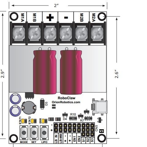

analogue into an arduino a-star controlling a robo claw controller in encoder mode hooked up exactly like in page 48 in the orion manual

    I am trying to write a program for the arduino a-star to accept analog input from a pot with 0 to 5 volt output, go threw the arduino a-star and come out of it with packet serial to the roboclaw in encoder feedback mode like a servo.

    Ignore my last comment. I forgot you asked how to use your encoder not your servos so here is the code I found in your datasheet.

    is line 9( RoboClaw roboclaw(5,6);) for PWM input on pins 5 and 6?
    0 e14 Contributor over 12 years ago in reply to nschreiber0813
    I am getting an error in this line  terminal.print(“Encoder1:”); terminal.print(enc1,HEX); terminal.print(“ “); terminal.print(status,HEX); terminal.print(“ “);
    And I think the error says,    stray "(" in program

    Sorry it took me so long to respond to your post I was running into a problem with my computer. No pins EN1 and EN2 are your pin inputs and outputs to your encoder. EN1 which stands for encoder 1 is your pins for your first encoder. Pins EN2 which stands for encoder two is your second encoder. Good luck.

    is this what you mean    terminal.print(“En1:”); terminal.print(enc1,HEX); terminal.print(“ “); terminal.print(status,HEX); terminal.print(“ “);
  • nschreiber0813
    0 nschreiber0813 over 12 years ago in reply to e14 Contributor
    Give this code a shot I am pretty sure it will workimage
