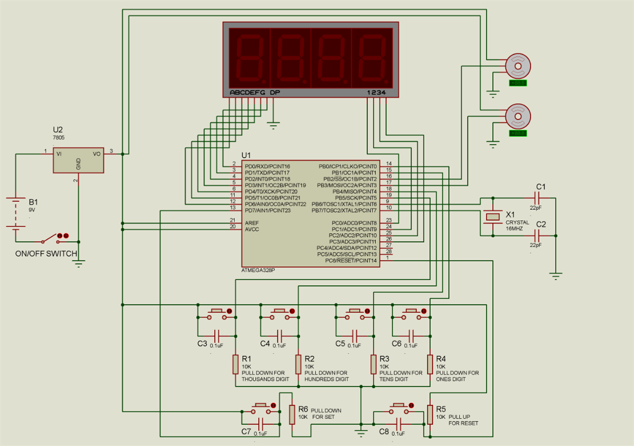

I have made the following circuit, can anyone please tell me why the seven segments are flickering. I have used multiplexing, don't tell me it is because of that. I have tried it prototyping on an arduino uno and it worked perfectly.SO its not because of the multiplexing!! and its not the code. I think something is interfering or resetting the microcontroller because it does not store the values on the seven segments.The motors on the right are not connected. Any clue what is wrong?

    RIshi, mcb1 told that there is a power problem NOT because the 7805 is a crap component but because, with a reasonable difficult we are trying to decode your info and seems that your schematic has issues…

    0 rishi2628 over 10 years ago
    mcb1
    clem57
    balearicdynamics
    Robert Peter Oakes
    Ok here is the complete circuit with EVERYTHING. Please note a couple of things:-
    1) I have not used capacitors with 7805, hope it does not cause any problem.
    2)The 5 volt output from 7805 powers 2 pwm servos and the atmega328p microcontroller. It is also attached to the input buttons.
    3)Even when i detach the servos from the circuit , the flickering still happens which is evident from the video.
    4)I have attached 0.1uf capacitors to every switch including reset button to prevent debouncing.
    5)I am using analog pins as output pins
    6) Lastly if anybody hasn't seen the flickering problem them please visit the link below, and note that for 20 seconds it works ok, then the flickering start.
    https://www.youtube.com/watch?v=hdxqWKZSfso
    Now here is the complete circuit:-
    (please open it in new tab for a magnified image)

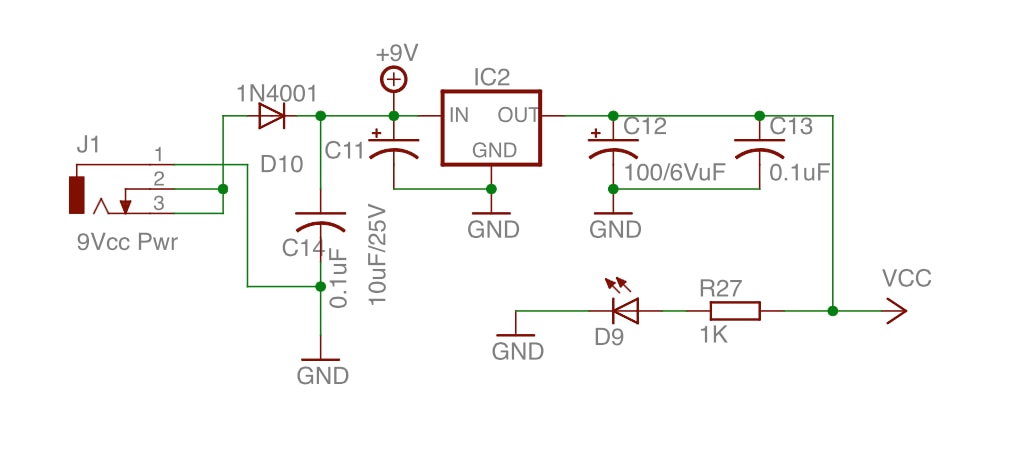

    0 balearicdynamics over 10 years ago in reply to rishi2628
    Many thanks, Rishi!
    Well, first of all the power regulator without capacitors (and few other discrete components) is not the worth. At least it reduce the life of the battery, but it is very probable that one of the causes of the flickering depends on this, plus many other issues.
    About the problem os the regulator, it is very probable that you incur in the ripple  issue. Whenever current is drawn from a regulator the voltage will start to drop but it is needed an amount of time before the regulator start increasing the voltage to compensate.  This is the ripple effect.  The amount of ripple will be larger if more current is drawn from the regulator so I suppose that when the system starts things seems going well but then the performances decreases as time go ahead; tale in account that the LM7805 as all this kind of regulators compensate the current with temperature dispersion so as time passes the system tend to be hot and the effect is more visibile..  To compensate the ripple effect just a capacitor provides a temporary bank of energy.  This is used to keep the voltage stable.
    As source of inspiration please see the schematic in the image below.
    Hope you are not offending if I prefer that this part is set correctly before we take in consideration more in depth the circuit. I think that your excessive simplification may really create serious unwanted behavior to your system.

    It's usually better to not power the servo's from the same source as the microcontroller but it is entirely possible with the right design. Most linear voltage regulator circuits should be built around a setup similar to the one balearicdynamics posted above with a small ceramic capacitor to smooth high frequency distortions and a larger electrolytic capacitor to provide extra power when needed.
    Moving on from, powering the servos from there directly and then placing a diode between there and your microcontroller with another capacitor after it will give your logic circuit it's own independent power reserve which would help prevent it from resetting during times of heavy load.
    I used this setup in one of my small robots that used 2 servo's powered from the same regulator as the logic and very rarely have power issues with it. They will occur if the servo's are pushed to their stall torque for any lengthy period of time but if thats happening then you should become more concerned over the possible damage to the serbo's and redesign the system around that.
