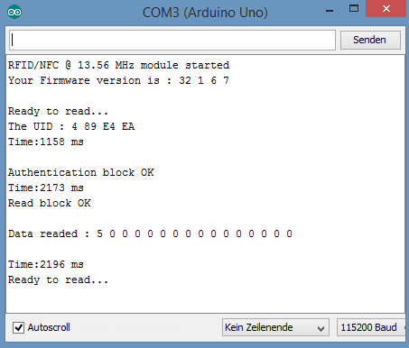

Hello,
I have RFID 13.56 MHz / NFC Module for Arduino from Cooking Hacks , I want to know how much time need a full read in a block process ?
I tried with millis () function and I get this :
I get 2196 ms .  is that right ? I think it's so much
Rita

    It does seem a little slow but I dont have one to try out so nothing to compare to
    What is the code your using to time the read, can you please provide in here
    Thanks

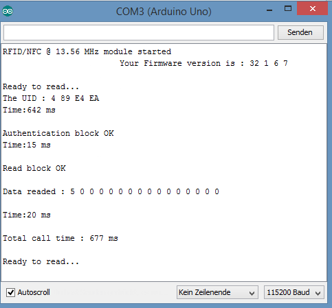

  • Robert Peter Oakes
    0 Robert Peter Oakes over 10 years ago in reply to ritamüller
    ok, try this

    unsigned long time;
    unsigned long loop_time; // less the 2 second delay... dont forget
    unsigned long function_time;
    void setup()
      //Start serial port 115200 bps:
      Serial.begin(115200);
      delay(100);
      Serial.println("RFID/NFC @ 13.56 MHz module started");
      delay(1000);
      //!It is needed to launch a simple command to sycnchronize
      getFirmware();
      configureSAM();
    void loop()
      Serial.print("\nReady to read..."); // optimise the prints by putting the new lines in the same print as the actual print
      loop_time = 0; // reset the loop timer
      //Get the UID Identifier
      function_time = millis(); // we already had a one second delay in setup that is not part of the timeing so lets start with a clean count
      init(_UID, ATQ);
      time = millis() - function_time; //prints time to get the UID
      loop_time += time;
      Serial.print("\nThe UID : ");
      print(_UID, 4);
      Serial.print("Time:");
      Serial.print(time);
      Serial.println(" ms"); // dont need the space and the ms on seperate prints, just do it in one, also by using println you get the new line at the end automatically
      //Auntenticate a block with his keyAccess
      state = authenticate(_UID, address, keyAccess);
    time = millis() - function_time;//time the call
      loop_time += time; // add this call to the overall time
      Serial.print("\n");
      if (state == 0) {
      Serial.println("Authentication block OK");
      Serial.print(time);
      else {
      Serial.println("Authentication failed");
      //Read from address after authentication
      state = readData(address, aux);
    time = millis() - function_time; // time the call
      Serial.print("\n");
      if (state == 0) {
      Serial.println("Read block OK");
      else {
      Serial.println("Read failed");
      Serial.print("\nData readed : ");
      print(aux, 16);
      Serial.print("\nTime:");
      Serial.print(time);
      Serial.print("\nTotal call time : ");
      Serial.print(loop_time);
      delay(2000); // wait 2 seconds before we loop again

    I took out some redundent print statements (Or not necessary as they can be optimised into single line), I hope this did not break the code
    The main mistake you where doing is this
    the main loop has a 2 second delay in it, you where not eliminating this from your timeing, second you had a one second delay in startup, this was also included in your time, then you also had all the print statements to the screen (Console) also included in your time
    What I did and the main change in your code is introduce a seperate timer value "function_time" that is set to millis() just before a call to read the chips, then I subtract it from the new mills() once done, this tells us how long the function call actually took. The "loop_time" simply adds up all the funcrtion_time values to see what the total is without having to keep track with a calculator after a run
    Hope this helps

  • ritamüller
    0 ritamüller over 10 years ago in reply to Robert Peter Oakes
    It seems better
    Thanks for reply.
    Rita
    good, that first one still seems a little slow but that may be its nature
    Glad it helped
    Peter
