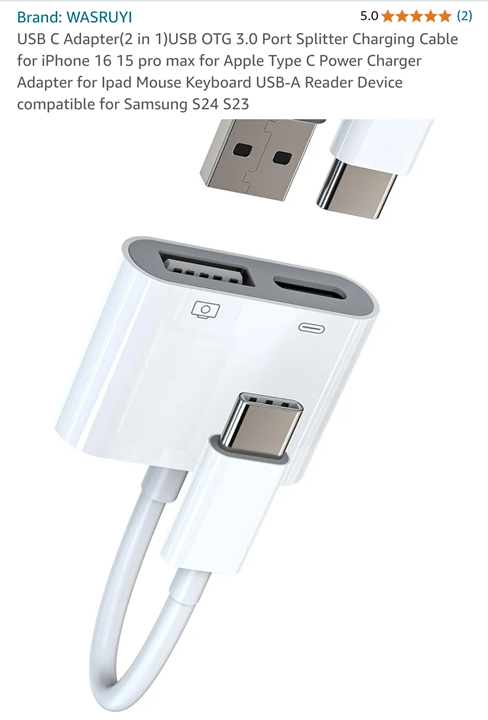

    0 shabaz over 1 year ago
    Hi,
    I agree with everything Wolfgang mentioned.
    If you want to make life easier, it is possible for a few $ to obtain a ready-made USB OTG cable with extra port for charging. It will contain the electronics to ensure the type A port doesn't see excessive voltage.
    Similarly, you could use a ready-made USB-UART board or adapter to plug into that type A port.

    0 mjones517 over 1 year ago
    Today was interesting and I've learned some stuff.
    I decided step 1 was just getting the MCP2200 to register as a serial device. I could not get this to work for the life of me, not even on my laptop. I suspect wolfgangfriedrich is correct and I need to add the 12 Mhz crystal. I don't have one, so I can't test for sure.
    Out of frustration I plugged my Arduino directly into my Pixel 6 and opened a serial monitor app. I was able to directly connect, no intermediate chip required. I even got an LED to turn on / off.
    I think the solution I'm going to take is to do that and also buy the USB OTG cable shabaz suggested. That will accomplish everything I need to make this project work.
    My last project used a Raspberry Pi. I realized at the end the only thing I needed the Pi for was GPIO, and that the rest of the project would have been cheaper / easier if I could have just used an Android tablet. Now that I know I can control an Arduino using serial commands, I can skip the bloodbath of trying to find / use a Pi.
    Thanks again for everyone's help! As you've figured out I'm a raw newbie.
