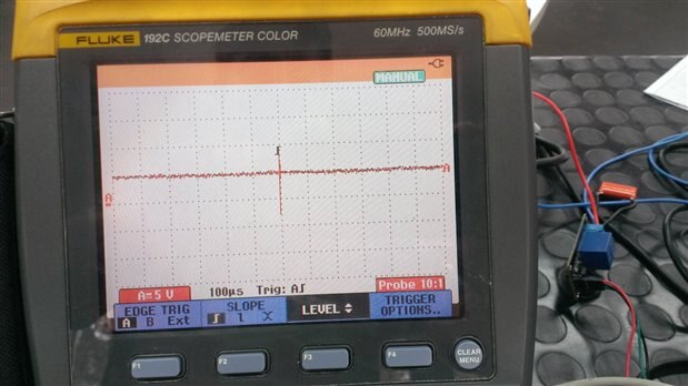

    I've been reading around and I found that adding a capacitor in the relay's output connections would help. The thing is when the relay latches and delatches creates an electric arch strong enough to mess up with the coil and the 5V supplying it!
    I add a 0.33uF capacitor and I get better. I didn't have any LCD problem for 20 minutes (way more time than before!) and this is what I've got on the scope with the capacitor plugged in:
    Now, I don't know if this is an "acceptable" spike. I don't think so but I'm not and expert. It obviously isn't a perfect solution though.
    Another thing, when I turn on/off the system's 230V connection, I get some noise too. (Just by turn the 230V switch on). Is there any easy way to get rid of this "switch on noise"?
