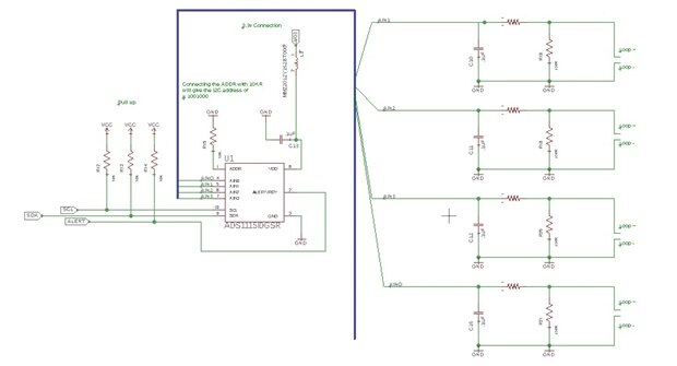

  I`m currently making some proto circuits and I would love some feed back/Ideas etc.
All these circuits will connect to Arduino or Arduino compatible devices.
Anyone have time to help out with some reviews?
First circuit is a 4-20ma board

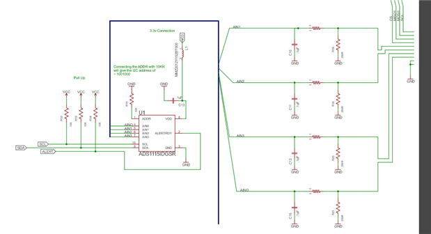

    Ok here is the 4-20ma part. Dont pay attention to the SPI items
    genebren over 8 years ago in reply to s1buell
    So, it looks like you have 4 inputs setup for 4-20ma range, generating a 1-5V output to be read by the analog inputs.  What would you like to do with the inputs?

    s1buell over 8 years ago
    Ok so here’s the Idea for the 4-20ma, I`m looking to read general 4-20ma sensors loops.
    The board has a 12volt power supply for the transmitter (if needed). I want to connect these inputs to a feather type proto board.
    You might need to modify your 4-20ma loop front end somewhat.  First, the circuit as shown does not have a return path for the current loops.  Also, the current loop may not necessarily be directly referenced to ground (a lot are not, some are completely isolated).  A more typical solution is to differentially sense the voltage drop across a resistor that is directly connected to the two signal lines of the loop.
    Gene
  • s1buell
    Wow missed that one. Completing the loop would be nice.... image
    Tom,
    Again, I am not sure that you can count on the second leg of the 4-20ma loop to be at ground potential.  You might end up shorting out a driver or introducing ground noise into the circuit.
    Here is a link to some information on the risks of assuming a ground potential on the low side of the loop.
    https://www.dataq.com/blog/data-acquisition/4-20-ma-current-loop-measurements/
    Also, not all 4-20ma loop devices are actually supplying current.  There are passive devices that act as a variable resister, and the measuring circuit actually supplies the drive.
    On the outside simple.  But potentially quite complex.  If you know the devices that you will be receiving from, then you can make some simplifications to the measuring circuit.
    Gene
    Tom,
    Here is an even better link.  This shows how to differential sense the loop current.
    https://www.sensorsmag.com/components/implementing-a-4-ma-to-20-ma-sensor-interface
    Good luck!
    Gene

    abrain over 8 years ago in reply to genebren
    Another useful source I found was instrumentation amplifier data sheets - the AMP04 from Analog Devices has a suggested 4-20mA receiver circuit that also shows some TVS protection diodes being used to protect the inputs, which could be useful in an industrial application?

    s1buell over 8 years ago in reply to genebren
    Great info but I have a problem with the shunt resistors. My goal is to create something general to be used with most 4-20ma sensors.
    Is this possible?
    I checked out the AMP04 like the circuit but the -15 +15VDC supply becomes an issue.
    I also found the RCV402 but there are expensive (old chip too). Anyone know of something newer and similar?
    I though making a general 4-20 industrial loop would be easy…… well. Simple concept….. so many options….. lol
