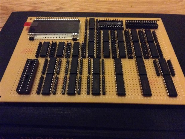

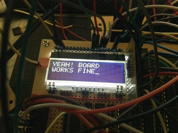

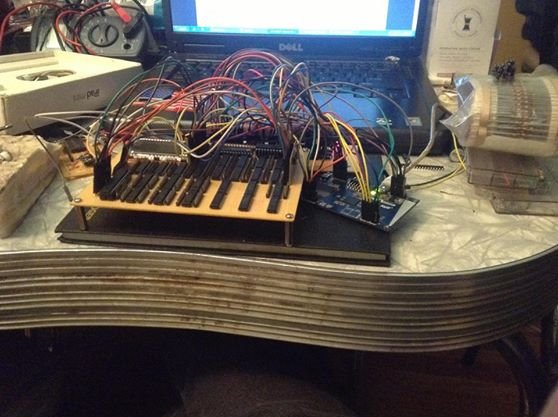

Hi Everyone!
I've been making a digital logic processor that has two ATmega328p MCU's on-board.
So far, I have the unit working through USB using a USB CDC protocol and have the
board processing digital logic through 7400 series logic.
I just got the firmware programmed into the MCU's today using a UC3A3 Xplained as the ISP through SPI
The board also has an LCD display, and I've started programming up a game for it called Super Micro Man
where the character is one character in size. https://www.youtube.com/watch?v=WD7Nmx1yU0E
Details and Specs for my LX-328 board are:
Two ATmega328p MCU's running on their internal RC oscillators.
Two of each: AND, NAND, XOR, XNOR, OR, NOT, and NOR gates for comparing 2 bytes at a time and giving one byte output that is captured into a corresponding 74hc165 shift register.
Two dual 2-4 line decoders
Nine 74hc165
Three 74hc164
Electronic Assembly DOGM163S-A 3 line FSTN display.
Four AT45DB651E 64mbit Adesto DataFlash on two plugin cards.
Two 64k x 1 Cypress 7Y7C187-35PC SRAM
Here is a demo video showing one of the MCU's working right after I uploaded firmware and bootloader to the blank MCU: http://youtu.be/KezzU8PZMIc
I've also attached a document describing how to program the ATmega328(p) manually through ISP with SPI from another MCU.
You simply redirect the opcodes to the target from the host MCU through USB with ChipSelect on the target's Reset pin.
Here's a brief on what the board does and how it is working the digital logic internally: https://www.youtube.com/watch?v=no6mcuZ7e48

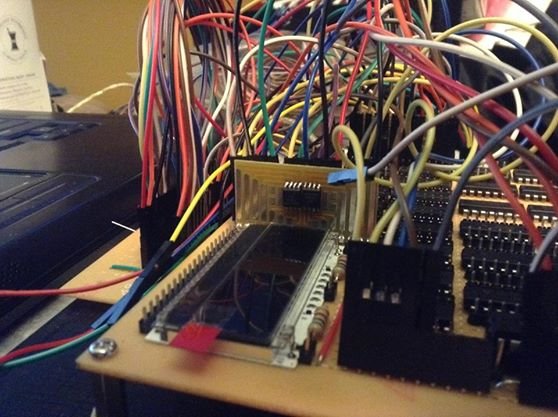

    I spent the day rewiring the board twisting groups of wires together into braids to make the appearance a little nicer. It also helped to make the board easier to get around. I placed the MCU's on the SPI bus so now the MCU's can be selected in ISP mode directly. I might hand it a boot option where users can select which device they'd like to boot from, like SPI0-SPI3, EEPOM0-EEPROM1(MCU EEPROM). This might come in handy being able to select the MCU's to read and write from EEPROM contents without disturbing each MCU's flash. I can give them the option to Save EEPROM so upgrading flash won't format the EEPROM data. There might not be a need to update flash firmware, but with access to the MCU flash, some users might be enticed to update but it could make the board inoperable. For this, I can create forbidden opcodes unless the user is in some sort of Administrator mode. This could be accomplished by a boolean, IsAdmin. If IsAdmn == true.... I'll be creating the command prompt over the next few days. There will be 6 devices the user can boot from, any of the SPI loading from 0x0000 or from either MCU EEPROM. With a list of opcode instructions available to the user, they can freely develop their own operating system contolling data flow. The other thing is you could still read and write to the boot device. Perhaps the bootloader could be 256 or 512 bytes. 1 or 2 pages in the boot section of the device. Maybe I could place a byte at the end of EEPROM in one of the MCU's that shows which device to boot from, and how many 256 byte pages the bootloader is since it can be written to 100,000 times. High 4 bits show which device to boot from, and Low 4 bits show how many pages the bootloader is. Guess it could have up to 16 pages of 256 bytes available in each page.

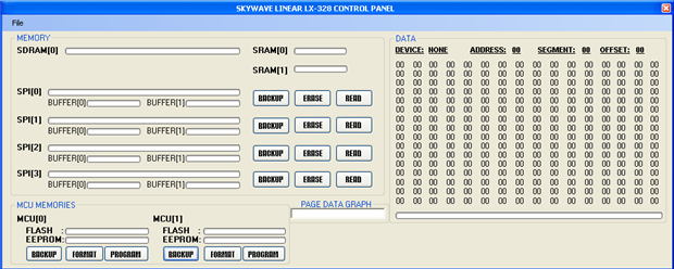

    Was working on a control panel in Visual Basic.Net today to access all memories on the board. I'll be handing it an automated and a manual mode where manual mode would allow controlling the board through data entry entering hex chars, and the automated mode would operate automatically incrementing stack and instruction pointers. One more week and the majority should be finished. There's an SPI based display headed this way so I'll definitely integrate that into one of the SPI channels.

  • iexpress
    iexpress over 11 years ago in reply to clem57
    Yay! I'm very excited, but I've been controlling it in real time entering hex chars through the keyboard. With the hardware working, I can go ahead and create a way to increment and retrieve data from flash or either of the MCU's EEPROM. Also working to develop some sort of command prompt, but I'll probably have to make some custom peripherals for data entry if the board is used in standalone automated mode.
    The board should give beginners a chance to understand the 7400 series logic with the addition of SPI-based storage solutions.
    Creating a user guide might take about a week, but I'll cover everything from running the board in real time using the opcodes, to creating apps that run automatically from any of the storage devices on the board. Currently there are 6 non-volatile memories, but the SPI-Flash also has two 256 byte buffers a piece available to the user.
    Still not sure if there is a way to access MCU SRAM in ISP programming mode, but this is how I'll be having it access Flash and EEPROM.
    Perhaps the drive labels could correspond with the devices, SPI0:\ EEPROM0:\ etc.
    We'll get there, it'll take about a week to finish a bootloader but the user guide will even cover this.
    For updating MCU Flash, I'll just have the VB.Net app handle ISP programming in circuit through USB CDC.
    No more wondering how to get code onto the MCU's that are blank and don't have their own bootloaders.
    I spent a day or two understanding how bytes are written to the ATmega328P Flash, 2 bytes per address.
    Hex files show one byte per address, but the loading address is the first address shown in the hex file.
    From there, I can have the VB.Net app upload data into either of the MCU's.
    I also made them removable so they can be replaced and reprogrammed very quickly.

    A new SPI display? Please do post a new picture after this has been integrated. I would love to see new changes as they are implemented.
    Good idea on making the MSU's removable.
    I have had a few ATmega's and even a couple 555 timers burn out on me. Having those DIP sockets really do prevent the tedious work of having to de-solder when this happens.
    As I mentioned before, boards like this are great educational pieces when learning not only 7400, but basic logic in general.
