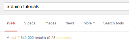

    mcb1 over 10 years ago in reply to Former Member
    Aisha
    We've said this many times before on the forum ...so you'll excuse me for sounding a little short.
    You can search within the forum and find some other replies as well.
