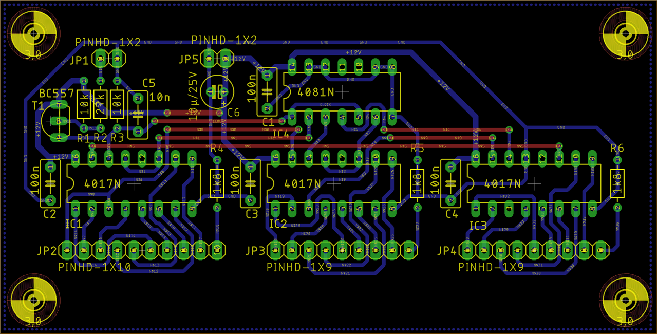

Attempting to make a Cornhole score board with 21 lights that light up at each button push.  At the end of the chain i want it to shut off the lights so there is none.  I am very new to this and have only gotten to the research part.  Any help i can get will be amazing.  Thank you.

    geralds over 4 years ago in reply to Josephmbrandtii +5
    Hi, here a suggestion: As I saw you have drawn it from the example from the datasheet. Now this is the complete circuit including the bypass capacitors and one of a possible method to make the…

    Would it be able to be wired to light up one at a time?  And then after 21 shut off all lights.
    0 shabaz over 4 years ago in reply to Josephmbrandtii
    Yes. On the face of it, based on what you have stated, those addressable products (either a strip, which might be a bit cheaper, or the pixel strings which might look better, would meet your need, and would be perhaps the easiest and quickest way to achieve it. They are often known as 'neopixel' if you wish to search for it.
    They will work with pretty much any Arduino board, or even Pi Pico board, depends on your preference. If you google the board name that you choose, along with the text "neopixel" you'll find plenty of example code to control individual lights. The link that javagoza and beacon_dave have provided would be good examples to start with.
