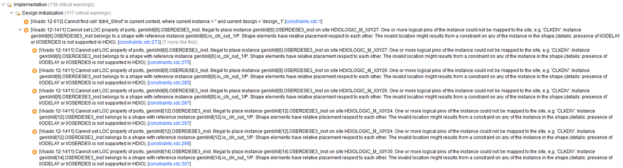

I can see a warning in vivado- v 2024.2 tool mentioning illegal placement on those pins. Even though this is a warning, I could see signal integrity issue in the output.

Attaching the warnings for reference:

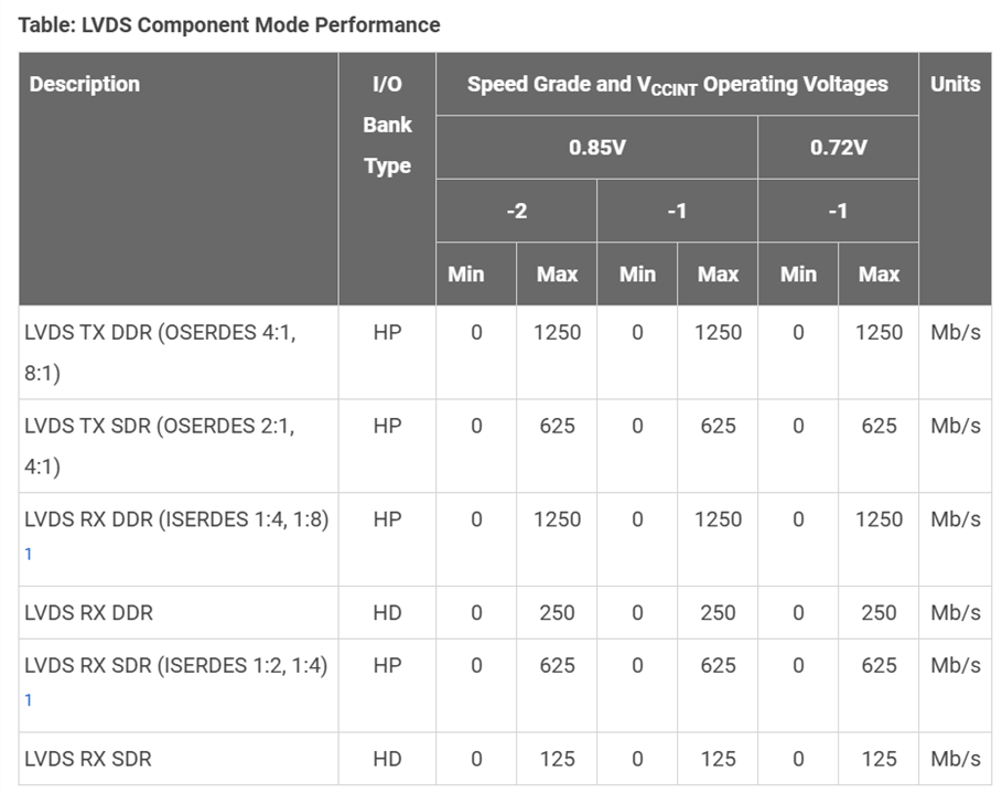

  • iksevas
    0 iksevas over 1 year ago
    Based on the table below, it looks like that is a limitation if you need to use the HD_DP pins for the data lanes. The issue above seems to be that you are using OSERDESE3 which isn't compatible with HDIO.
