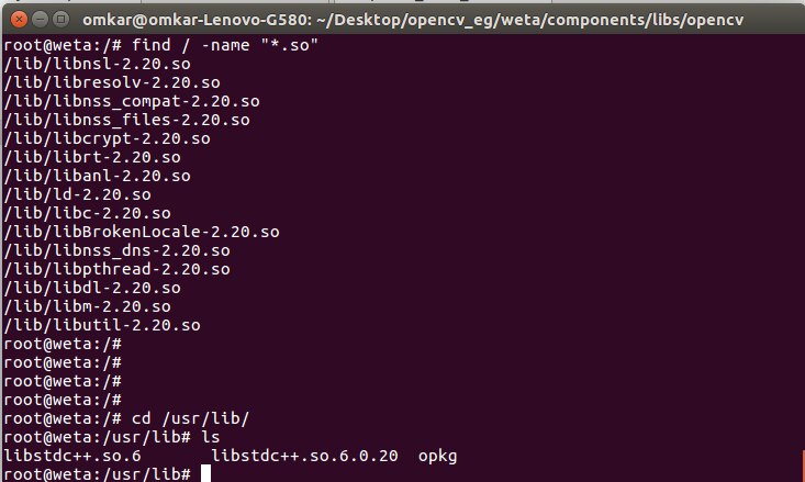

    From the ug1144 , Pg:62 I tried to add the opencv libraries from SDK folder.
    Now I used 'find' to know if the libraries are included in the newly built petalinux. Including the screenshot below
    When I run,
    error: while loading shared libraries: libavformat.so.54: cannot open shared object file: No such file or directory
    Also I edited the makefile accordingly while adding the libraries.
    Also I'm looking into the links you've provided and will revert back if there is any progress
    Regards

    Try using a utility like "ldd" to find the shared libary dependencies of your application.
    Based on your findings, you can install the missing packages.
    Regards,
    Mario.

    0 e14 Contributor over 9 years ago
    Hi Kevin & Mario,
    [1] while using ldd, a message saying that "it is not a dynamic executable" so I tried using readelf and... all the shared libraries are present in the image created
    [2] While building petalinux again, this error is coming. "[ALL  ] /opt/pkg/petalinux-v2015.2.1-final/components/linux-kernel/xlnx-3.19/Makefile:925: recipe for target 'vmlinux' failed
    [ERROR] make[4]: *** [vmlinux] Error 1" I've searched and found to disable docsrc in kernel. But it is already disabled. Also i've tried to disable the advanced bootable images storage settings in auto hardware settings from petalinx-config. But no use. Can you please say me how to solve this ?
