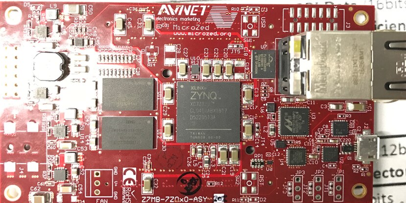

I have MicroZed Industrial grade. There are no jumpers JP1, JP2, JP3. So I cannot boot it from SD card.

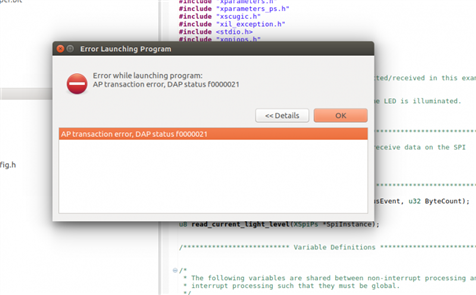

I don't see anything on the COM port. I can only Program FPGA but when I try to run simple Hello World - Launch on Hardware, it gives me these errors
An internal error occurred during: "Launching System Debugger on Local hello1.elf".
No Active System
ERROR : fpga initialization failed
Error while launching program:
AP transaction error, DAP status f0000021

    The way I received board is, jumpers are in default connection to boot from QSPI. There is no way I can change its boot configuration, that's why I am not able to load a uBOOT file to SD card and boot it from there.
    If you want to give me an email I will send the picture of the board. I won't able to upload pics here. Don't know how it passed quality control.

    Hello Vatsalnaik,
    What you have is a cost optomized industrial grade MicroZed. Please see this post for more detail: http://zedboard.org/content/what-cost-optimized-c01-microzed-som
    Did you mistakenly order this board? Also are you using a Carrier Card with it? Please refer to this post in why a carrier card is needed http://microzed.org/zh-hant/node/6926

    Hi Josh,
    Yes, I ordered Industrial version board.
    https://products.avnet.com/shop/en/ema/aes-z7mb-7z020-c01-i-g-3074457345628965481
    I wasn't expecting to be component stripped off version of MicroZed. The photo is misleading, and I'm not even able to use SD card to boot.
    I do have EMBV carrier card with this board.

    Hi Josh,
    I tried to run simple program but it give me this error. image
    Please let me know what can I do!  Thank you.

    08:08:11 ERROR    : AP transaction error, DAP status f0000021
